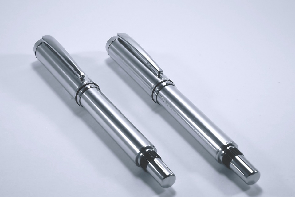

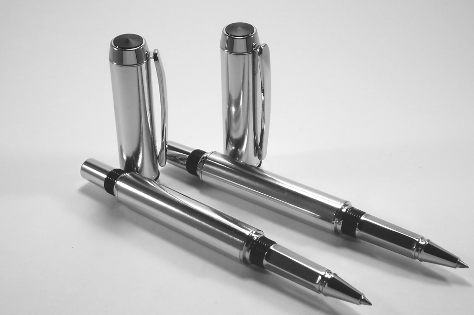

A good friend of ours sent these two Chrome Baron Roller Ball kits, and said he would like me to make Aluminum barrels to fit these kits. That was no problem. Finishing was a bit of a challenge, as it's been quite awhile since the last time I polished this stuff, as well as spraying with an aerosol can. Three coats of VHT high gloss clear. I personally like the slightly brushed look in contrast with the black accents, and Chrome parts. Thanks for looking!

Those are beautiful Chuck! I still have too many tools to consider a metal lathe (one that works :roll eyes:), but I may have to try it on my wood lathe. I've turned small segments, but never a full barrel.
Great set! I bet the bench likes getting messy again.
Thanks Mark! It CAN be done on a wood lathe. The beauty of the Barons, are that both barrels are straight from end to end. I actually have a 9" square area on the bench under the window now. :biggrin:

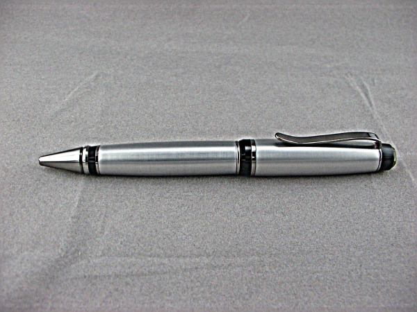

Very nice Chuck. Thanks for showing.
Mark it is very easy to do on a wood lathe. Turns just fine. The big thing is to keep the motor cover or if you have electronic speed control, watch the slag from getting into it. I have done it a few times.

Thanks John. I grabbed this from my IAP album to show Mark. It was a Christmas swap pen for Hans Wunch one year. I went on to have it powder coated red to keep in the spectrum of the swap rules. Had to be a Christmes color.

Professional looking pens. What type aluminum did you use and why did you spray them?
Ben
Thanks Ben. It is 6061 T6 If they are not coated with something, or anodized, the aluminum will turn your fingers black. I have the anodizing equipment, but setting it up is quite an operation, and I would no doubt have to call on Mike Redburn to help me remember the steps. :biggrin:

This is one I made 6 years ago and just kept it with a brushed look instead of highly polished. It still looks like new now. Has a few nicks in it because it is a desk pen that I use all the time. Made it on my wood lathe with no problem and at that time did it with just my skew. Did not own carbide tools.
