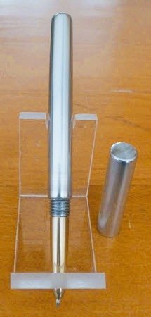

To test the progress that I have made over the past few weeks I decided to make a Cross style kitless from aluminum and brass on my wood lathe. I started from ½" diam aluminum and brass rod. Clearly, this is a project best done on a metal lathe, but I don't have a metal lathe, and don't intend to get one.

I love the design and the aluminum and brass!. Looks great.

Your efforts paid off! Like you I don't have a metal lathe and find both brass and aluminum fun to turn on the wood lathe, being softer metals. I like the curves you can provide on a wood lathe vs the straight style cutting on a metal lathe. The only draw back… they sure can turn a buffing wheel black!

Nice work! Are you worried about galvanic corrosion between the aluminum and brass over time? I understand they generally don't like to be in contact with one another for extended periods of time.
Nice work! Are you worried about galvanic corrosion between the aluminum and brass over time? I understand they generally don't live to be in contact with one another for extended periods of time.
I think to get appreciable galvanic action you need some persistent moisture. I will be sealing the metals with a protective spray to prevent oxidation, and that should also protect against moisture.
You are correct, the two metals in contact in dry air should not be a problem. Moisture could be an issue. The real issue is if you have consistent water flow in them.

What did you use to turn them? HSS or carbide?
