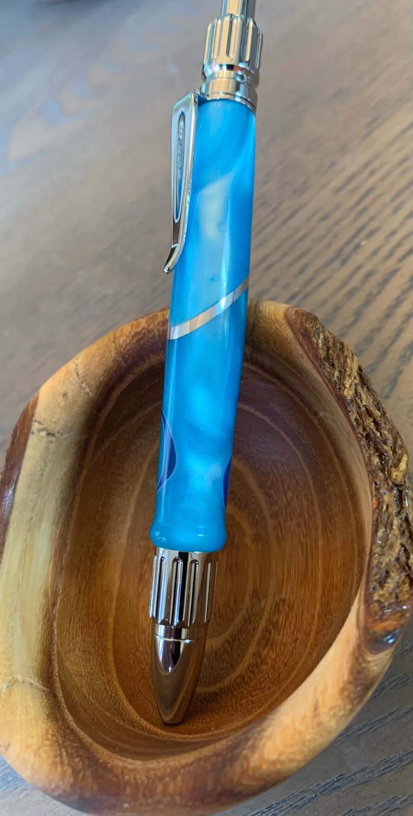

Aluminum accent stripe
JBarry
Dec 19, 2024
31
NC
Finally, I was able to complete this, but had to resort to drilling the aluminum before glue-up. Ninety degree hole, then elongated to accommodate the tube at a forty-five degree angle. Two-part epoxy was fine, whereas it had failed when I tried to drill the blank and metal after glue-up. I note that, for me, this is doable but not enjoyable.
Looks good. As was noted when drilling metals at an angle like that, there is a ton more stress on the glue joints and more failures. It is possible to do but a good sharp bit is needed and can not use brad point bits.
Nice job Barry. Heat causes the glue to break down. As mentioned before metal just increases the heat. In case you haven't tried this I've made splints and glued or taped to the blank before drilling. It really helped me in several cases. It should help with the stress put on the blank not only downward but wanting to slide as well.
In the past I have done that a fair amount. I found that going extremely slow helps, but more than that I turn it round to 1/2" or 5/8, measuring that with a 1/2" or 5/8 open end wrench as a gauge, then put it in a Collet chuck with the joint inside the collet. Works great to drill, but still go slow, backing out frequently and blowing it out with air for cooling and to get the chips out.
Yes it is a PITA to segment and subsequently turn and drill, but to me the effort is worth it in the end....or most of the time. I once made this segmented blank, and it kept coming apart...like 6 or 7 times. It was difficult not throw it....which I have in the past, and it did not do good things for the blank....I did have a blank that had more air time than the Wright Bros once tho, and I did eventually finish it.
Nice looking pen tho....good job!
