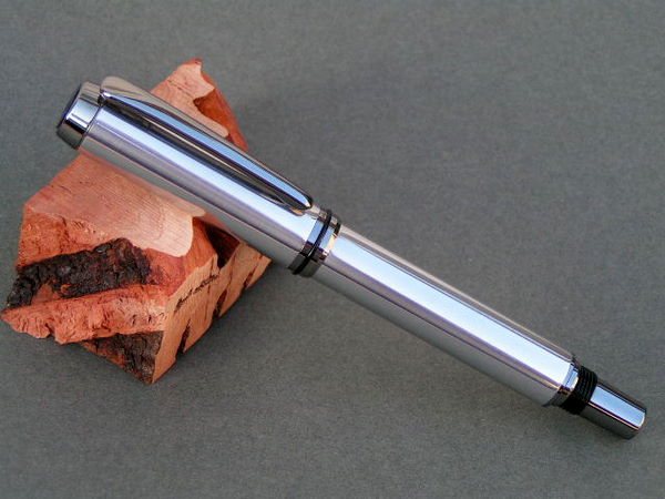

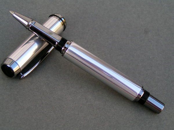

Hi everyone, this is something a little different from the Ligget Pen Works workshop, it`s an aluminium Baron rollerball with black titanium hardware.
I turned these barrels on my new metal lathe, then sanded on my DVR.
Barrels were purchased from Johnycnc (John Goodin) and they are a joy to work, another excellent product John!:D
Comments welcome!
Originally posted by Tanner
Oh, wow...that's beautiful!!!! Excellent, excellent job!! I like your choice of kit as well. Did you coat it with anything?
I wet sanded right up to 12000mm, applied 2 coats of Hut plastic polish then a coat of Ren Wax.
Only used plastic polish as I never had any metal polish, got some out shopping today though!:D

Absolutely beautiful Mark. It it tubed as pen normal blanks?
Chris you don`t need to use tubes with metal blanks, this Baron has none, you could use them if you want to I suoppose.:)
So, even more drill bits to buy, just what we need. Or do the different diameters for the fittings work with existing bits we would have in our usually very extensive pen bit collections?
Chris the best person to ask would be John Goodin (Johnycnc) as I never drilled these, I bought them already drilled from John.
The inside diameter accepts the push fit pen components very well as if you were assembling a normal tubed barrel.:)
