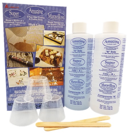

On side of bottle of my "Alumilite Clear" bottles that I got from Hobby Lobby:
Mix Ratio: 1 to 1 by Volume
Work Time: 30-40 minutes
Demold Time: 24-48 hours
This says nothing about "by weight" anywhere in the paperwork that came with it or on the bottles. I'll just assume that the formulation you are using is totally different, and has different instructions.

The printed instructions that came with the bottles also dictate the 1:1 ratio by volume. (used commas for the website thingy, using the proper periods gets it wrapped in html tags automatically ... rofl!)
Yup, I took a look at your link. You've found the wrong product for sure. A little browsing on their site let me find the correct one!
https://www.alumilite.com/store/p/1023-Amazing-Clear-Cast.aspx
Amazing Clear Cast

Alumilite's Amazing Clear Cast is a clear casting and coating system that cures to a rigid, durable, clear plastic. Use Amazing Clear Cast for coating or finishing applications such as bar tops, floors, taxidermy scenery, lenses, and all sorts of other clear casting or coating applications. Amazing Clear Cast is an easy to use, 1:1 mix ratio system that cures overnight which allows time for air bubbles to evacuate prior to curing. Amazing Clear Cast can be colored with Alumilite dyes, alcoholic inks, or other non-water base colorants.
Complies with FDA CFR 177.2600
Prior to use, read all Technical Data Sheets/Instructions and Safety Data Sheets linked below.

I found the product that I use, it's pictured above in my edited post ... this should clear up some of the misunderstanding.
THIS is the Alumilite Clear that we are referencing as buying from Hobby Lobby.
OK, that is not the same stuff as the Alumilite clear for turning.
That explains a bit, but hay - if it is working for you :good:
On the outer box/package for the bottles there is clearly a picture of a turned alumilite pen... If it weren't for that picture, I wouldn't have even tried it out ... it works great, though, I can't wait to make my first pen blank! :)

Late to the party. Amazing Clear Cast is an epoxy where Clear is a urethane. Totally different systems; totally different names.
It pays to be specific when talking about specific products!
