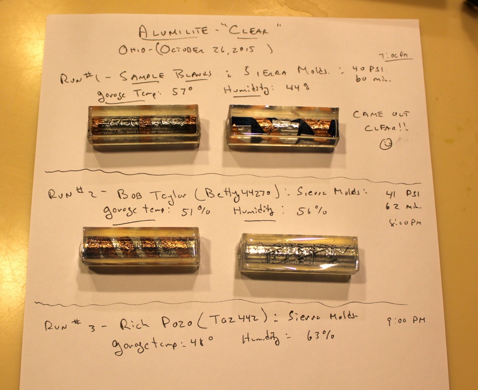

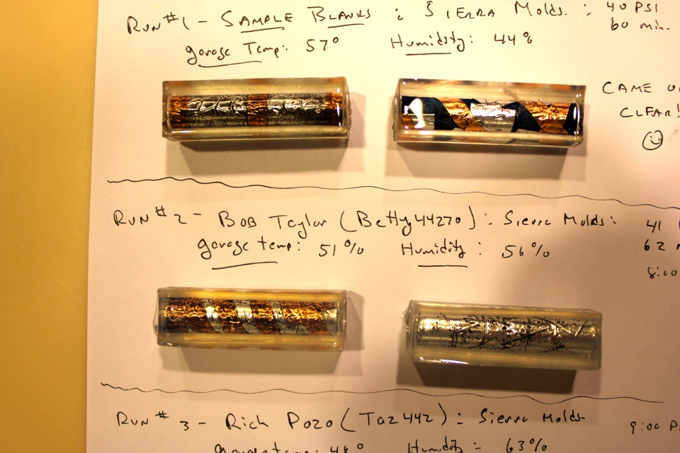

I did a trial cast in the garage just now (demolded 15 minutes ago) - 57 degrees in the garage; 40 psi for 60 min. a 2 Sierra mold, humidity at 44%, came out crystal clear (foil blanks)!
I have put in a second cast - tubes from my Ohio Club Members. garage temp is at 56 degrees.

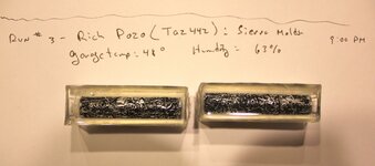

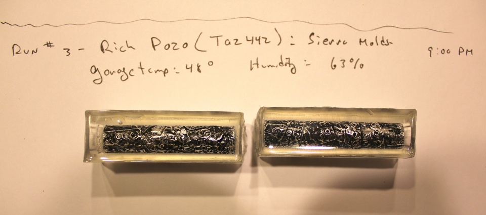

So Far - Last run - Garage temp 51 degrees; 56% humidity; 61 Min at 40 psi.
Came out crystal clear - and HARD. Like it had sat and cured in warm temp.
So, I have another (final for tonight) run in at 50 degrees and 59% humidity.
I Love working with Clear! Very easy and user friendly.
I wil take Pics in a few moments of the first few runs. For us folks in northern areas, this may be helpful.
Pictures are a bit dark as it is late into the evening; however...
All three runs came out very clear and hard.
