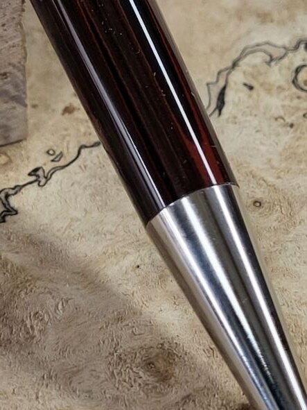

I use the carpolish from Festool. When festo started selling these products we got samples in small bottles. I still have a few bottles. Only the p 6000 disappeared. I asked a festool salesman and I got a used bottle. The samples are 100 ml and do not excit anymore. You can buy them in 0.5
This is the result. Y
ou can buy those bottles in 0.5 liter big for polishing pens.
