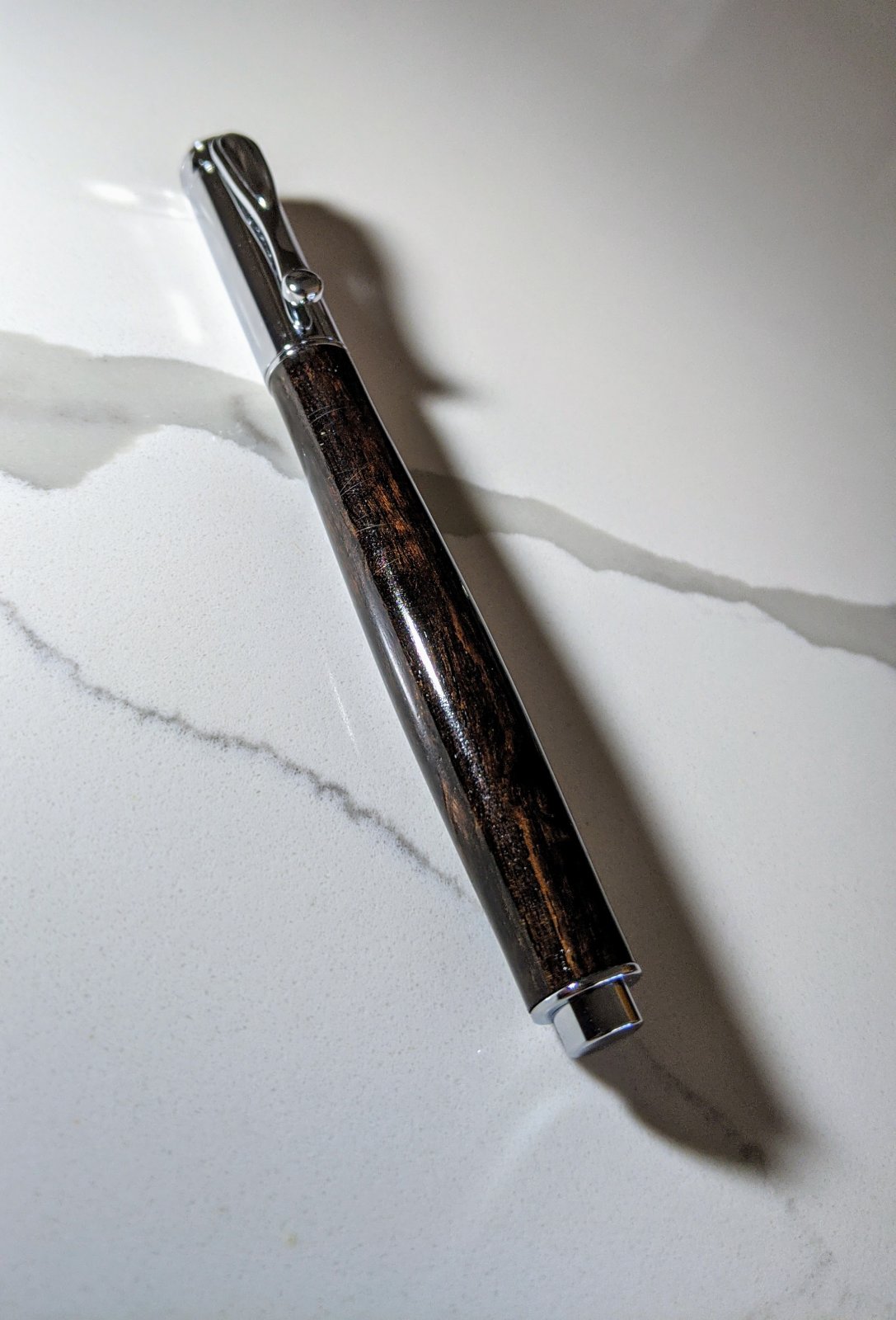

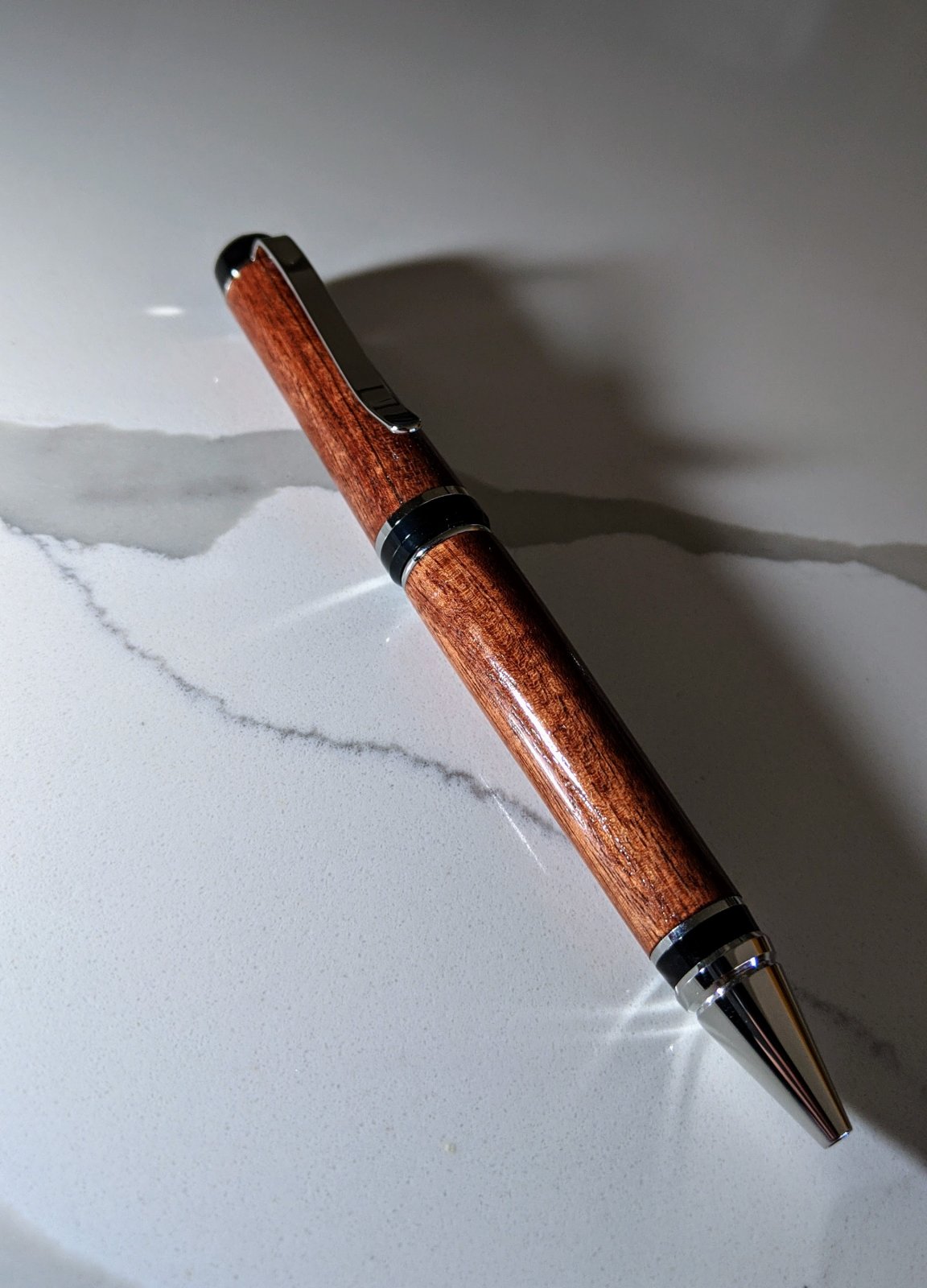

If anyone is still interested in pursuing a high-gloss alternative to CA, here is the process I used on two pens I recently made.
Although, I like a matte or slight sheen on most of my projects. I have been trying to achieve a high gloss and durable finish without using CA. I have been able to do so in the past using Birchwood Casey Tru-Oil on bubinga knife scales. The finish has held up really well over the years without the need for reconditioning. I thought I might try the same method on pens. I am posting this to share my process and experience with everyone. Please attempt this method at your own risk. Any feedback is welcomed with open arms!
Region: California (warm and dry)
Species: African Blackwood
Day 1: Sanded to 3000 grit. Hand rubbed Tru-Oil. Dried for 24 hours. Color of the wood was significantly darker, but shined great in the light.
Day2: Appearance was very glossy, texture was tacky (very slight) and rough. Sanded lightly with 2500 then 3000 grit at roughly 800 RPM. Appearance was dull with a few shiny spots where the pores were and texture was smooth after sanding. Hand rubbed 2nd coat.
After 6 hours: appearance is glossy, dark, somewhat difficult to see grain even in light with a few high points where run off developed. Texture was decently smooth.
Day 3: Appearance was dry, dark, and glossy, difficult to see grain even in full sunlight. Texture was smooth and dry. Lightly wet sanded with 3000 grit sandpaper, resulted in dull appearance with few shiny spots. Applied light coat of Tru-Oil (2 drops) with hand.
Day 4: Applied thin coat of oil hand rubbed
Day 5: Appearance was dark and glossy, shines really nice once oil is applied. Texture was smooth with only a few spots where you can feel a bump, possibly from dust? Applied thin coat of oil.
Day 6: Allow to dry
Day 7: Finished. Appearance is glossy, grain is dark, visible defect from user error. Texture is very smooth.
Species: Mahogany
Day 1: Sanded to 3000 grit. Hand rubbed Tru-Oil. Appearance is slightly darker with rich color. Grain pops nicely. Dried for 24 hours.
Day2: Appearance was very glossy, texture was dry and rough. Wet sanded lightly using 3000 grit and Tru-oil as lubricant at roughly 800 RPM. Hand rubbed 2nd coat.
After 6 hours: appearance was glossy, good grain detail, warm color. Texture was dry, smooth (not buttery). Applied thin 3rd coat with rag on one tube, hand rubbed on the other tube. Will how each one yields.
Day 3: Appearance was glossy. Texture was dry and smooth, but still not satisfied.
Day 4: Allowed to dry for 32 hours.
Day 5: Appearance was same as previous, getting more consistently smooth. Applied thin coat of oil.
Day 6: Allow to dry
Day 7: Finished. Appearance very glossy, texture was smooth.
What did I learn?
There are a few key points and takeaways that can be gained from this experiment:
• This process does not work well for darker woods, it's possible that my initial coats may have been too thick which may have resulted in an undesirable finish
• APPLY EXTREMELY THIN COATS, best results were achieved when 1-3 drops of Tru-oil was applied directly to the pen blank and hand rubbed using a glove.
• Allow each coat to dry for at least 24 hours or until most of the smell of the solvent has dissipated. Often times, each coat had mostly dried within a few hours, but were allowed to dry longer for precautionary measures.
• Have patience. This is a long process that is best done in large batches, but it is well worth the reward if you are trying to achieve a high gloss finish without using CA Glue.
