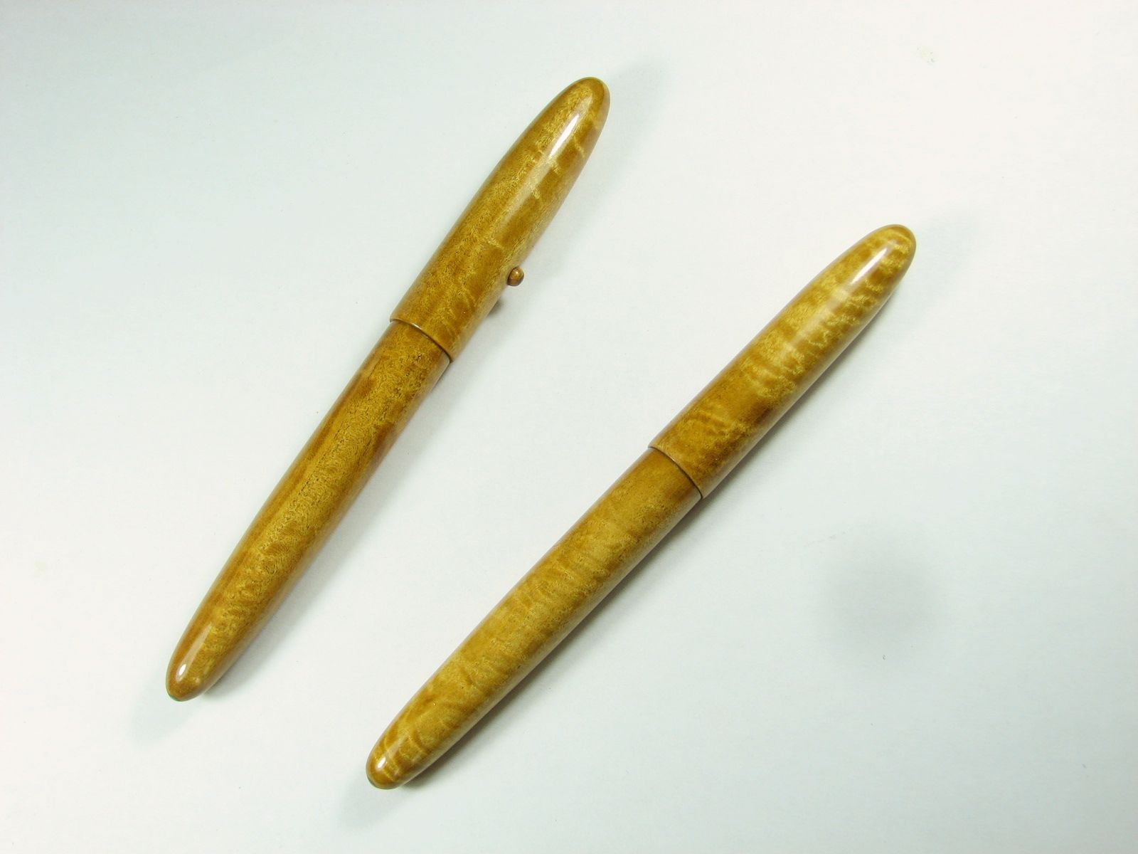

Urushi!
Warranted 2000 years, waterproof, swearproof, acidproof, anything between ultra gloss and satin.

Japanese lacquer, made from the sap of urushi tree. You apply thin coats and let them dry before polishing - or not.
Check manupropria or Teodor works on this forum.
You forget to mention the rash 😭. Urushiol (present in urushi lacquer and poison ivy) causes a fantastic itchy rash. I can show you pictures of the rash I got if you want. Urushi isn't easy to get currently, best quality comes directly imported from Japan, and Japan Post is not shipping to the US now due to COVID. It's worth the expense and itchiness (wear gloves) because the incredibly beautiful finish can't be gotten any other way IMHO.
P.S. Pierre forgot to mention that the Satinwood pen in his first post above is finished with multiple layers of transparent urushi which gives a beautiful glow and depth that is unmatched.
