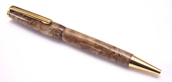

I turn most of my slims to resemble a 7mm euro like this. You could do the same thing with the 8mm euro kit. Put a piece of contrasting wood where the CB would normally go. No tenon required but you will need to have the equivalent of a closed end mandrel so you can undercut the end of the cap.

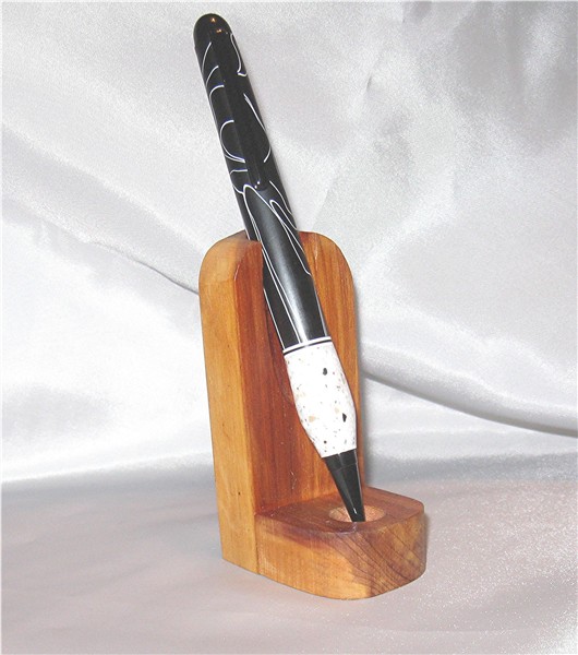

Here's a 7mm Euro, so it's a Cross refill instead of a Parker, but I moved the center band half way down the lower barrel and replaced it with a piece of pickguard epoxied to the Corian. I can't say how well it would work with a Parker mechanism.
Hey, that looks like mine!
