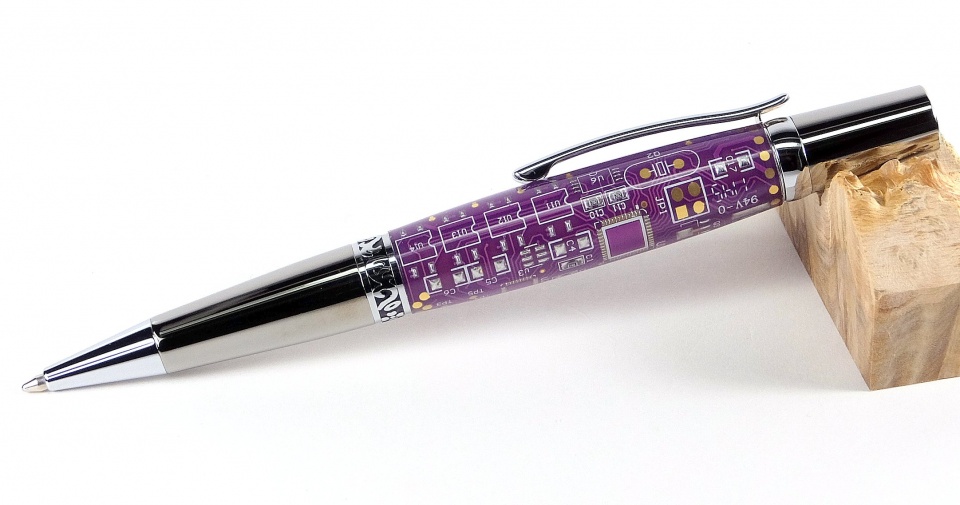

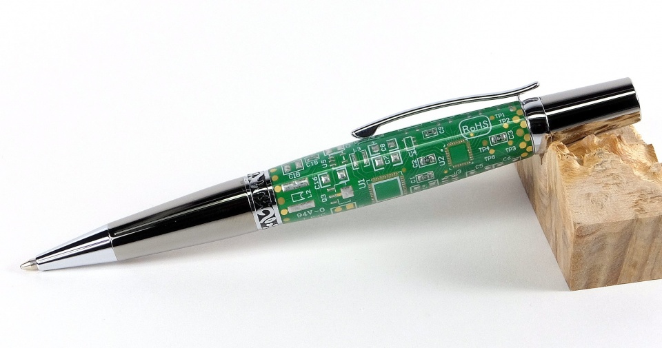

I have never used Micro mesh. After I use my Skew on the flat as a scraper I go to Triple EEE then a light crean briefly or Brasso or Auto Cream. Never used wet wet and dry either.
Please find two examples from today with printed circuit board pens.Flawless finish.
Have fun I do.
Peter.
Have fun I do.
Peter.
Thanks Peter. I am a slow learner! You just reformed me. I do the same as you -> on my segmented blanks - not putting sandpaper or MM on my segments (just a scrapper) and getting them as smooth as baby's skin. But why I run to SP or MM on CA, I don't know. Just pure old time habit.
I don't need that. Thanks for the "awakening"!!!
