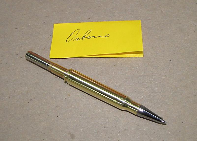

Got a customer request recently for a bullet pen with a standard slim-line nib-end in gunmetal grey(don't ask me). Not a problem I am thinking until I get it together and try to put in my Parker style refill. Duh:redface: it doesn't fit, imagine that. Well, I refuse to use a cross style refill in my custom pens unless they are actually slim-lines. Question: Does anyone know of a slimline style pen that uses a Parker refill. The slimline nib-end IS a perfect fit for the end of a 3006 cartridge case so using the SLPro or similar is not an option. IF I can't come up with a Parker-SL-Nib-End then I will try turning the tip down on one and re-drilling it for a Parker and hope I don't mess up the finish too bad. The photo is one I took to send to the customer showing him the problem with his request.

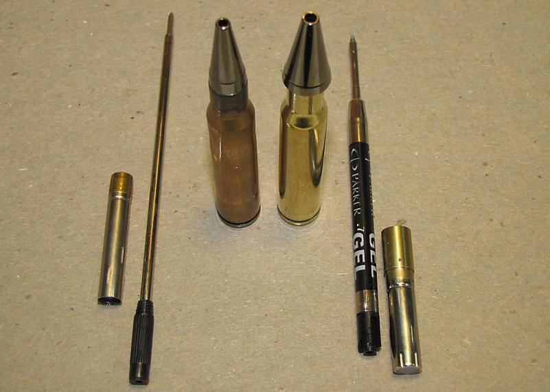

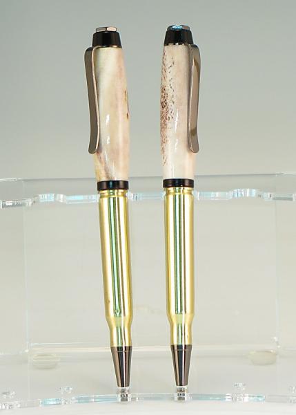

Thanks everyone for your comments. I thought there would not be enough meat left on the nib end to drill a larger hole but I was able to re-drill the holes to fit the Parker refills. The pens actually turned out pretty nice. Here are some pics.
This is what the final sub-assembly looked like with the Parker. (Osborne is the customer's last name.)

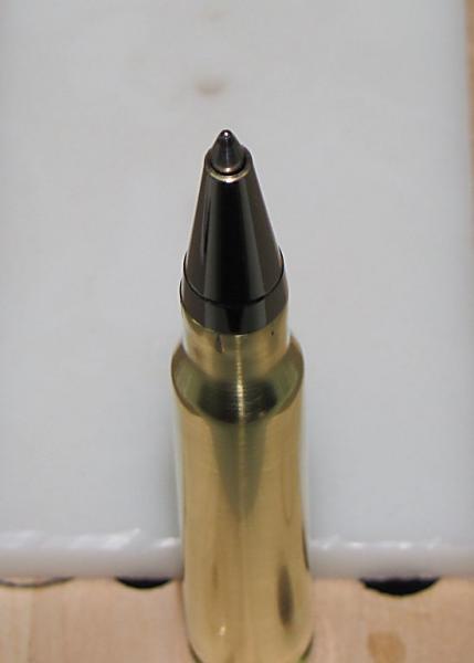

The end of the nib section.

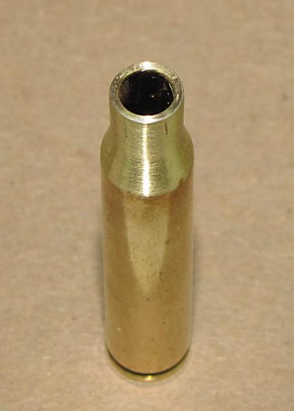

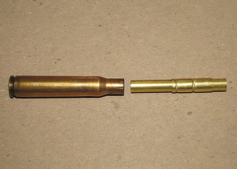

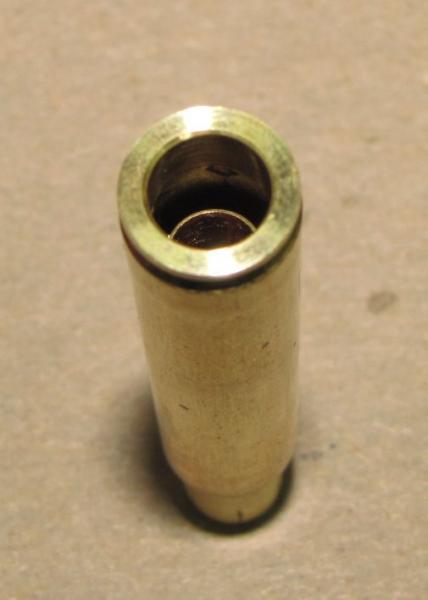

Resizing the ID of the cartridge neck by soldering in 7mm and 8mm tubing.

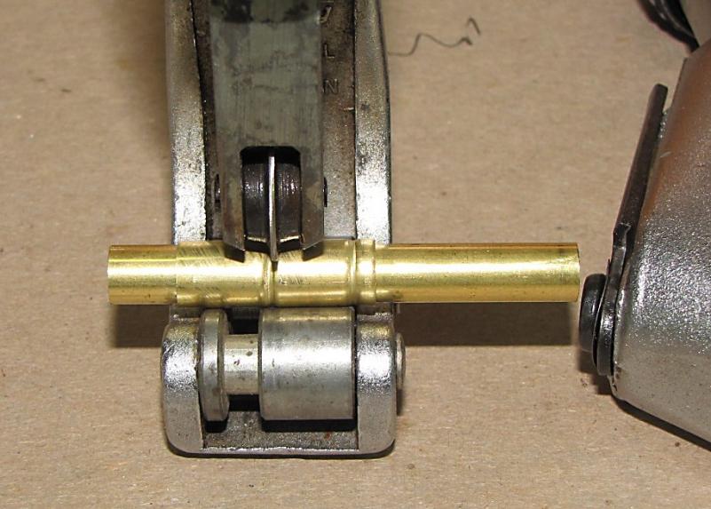

I had to add some internal ribbing to the 8mm tubing to center the 7mm.
I have two pipe cutters. One of them I dulled the blade on a grinding wheel and it makes a great "ribber".

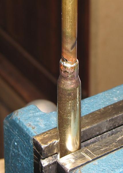

The combo was a nice snug fit into the neck of the cartridge.
The results of the ID change after soldering and doing a little machining. The SL nib pressed right into it.

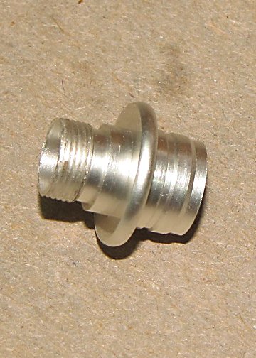

"I turned down a cigar center coupler(available from Wood-n-Whemsies) to fit a 5/16" hole i milled into the case through the primer. I pressed it in incrementally until I had the right protrusion of the refill point."
Edit: Just a note on the case. The case was from a fired blank. The blank was the type with a crimped end where the bullet would normally be. The crimping and subsequent re-straightening of the neck usually splits the neck length wise at several of the crimps. I turned off about 3/32" from the end of the neck to remove much of the splitting before resizing the ID of the neck. The resizing not only narrows the neck down to the SL nib tenon but soldering of the tubes reinforces any remaining splitting. Removing the 3/32" also allows the couplers first shoulder after its threads to be pressed into a near flush line with base of the case when using the slimline nib.
Hope this answers the question and is helpful to others as well.
This is the unmodified cigar center coupler that the tranny screws onto. My apologies for the out of focus pics.:redface:

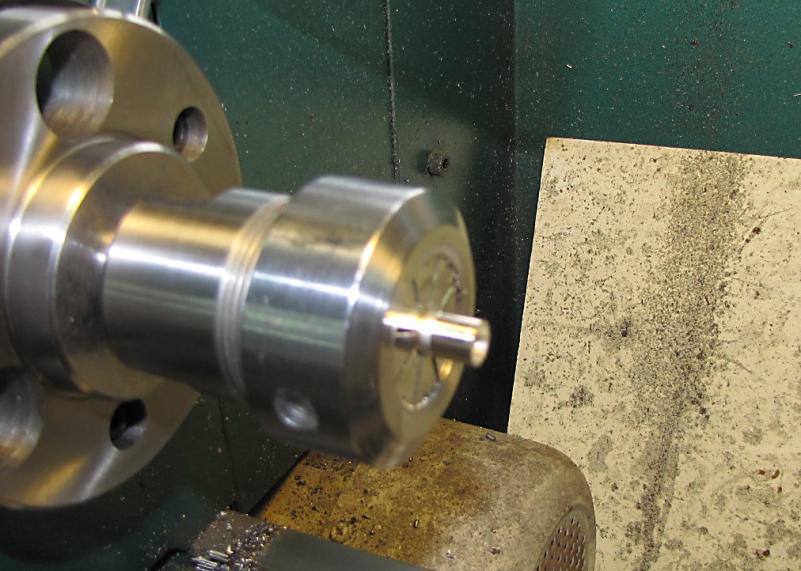

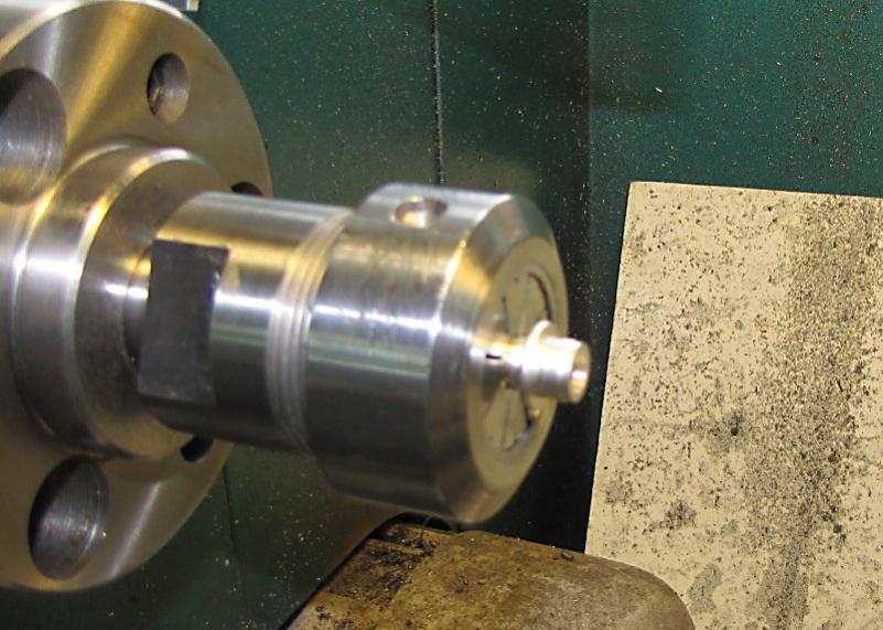

I screwed the coupler into a tranny then chuck the combo up in a collet chuck on my metal lathe. The coupler is brass so it could be done on a wood lathe as well.
I turned it down so that it was a press fit into the 5/16" hole I milled into the brass case. (BTW I say milled because I drilled it on my metal lathe:rolleyes: using a 5/16"x60* center drill. The few times I have tried a jobber or other bit the hole was not true and centered even if I started it with a pilot.)
