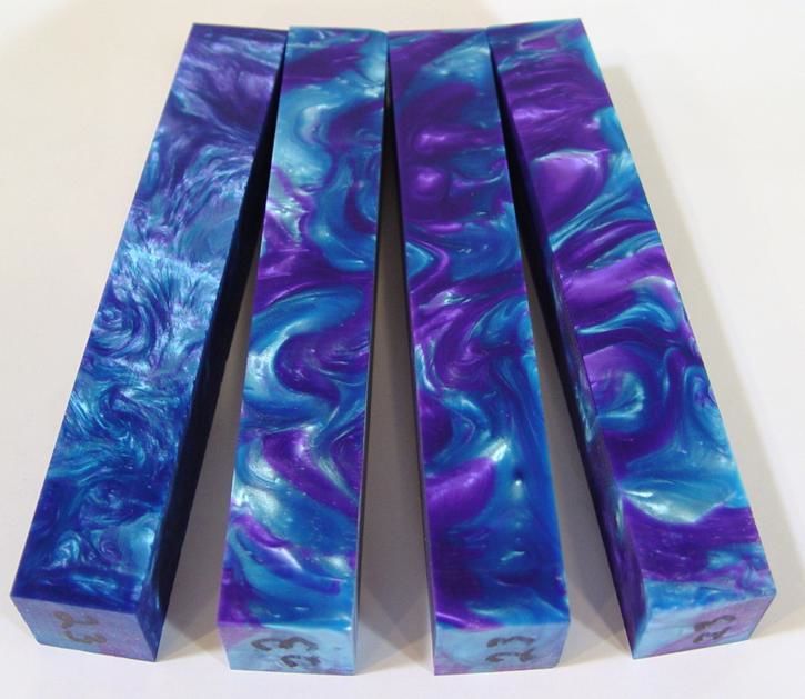

Hello folks. I'm curious to know if those of you who cast with Alumilite use any other dyes other than those offered from Alumilite. I have done some experimenting with mixing primary colors and such but have yet to get those brilliant colors I'm seeking.
What works best and what other manufactures offer a larger selection of dyes?
Thanks in advance to any and all comments.

I use the pearl-ex powders and alumilite powders too. I'm just wondering how to get those awesome "cobalt blue" and deep turquoise type colors across the color spectrum. Is it just a matter of combining the liquid dyes and pearl-ex powders to get those truly amazing colors? For example:

YES. You can do all of that with the Alumilite dyes. I have never understood why anyone would want to use other dyes. Alumilite dyes are made to properly crosslink with the urethane and the price is cheaper than most other dyes.

Thanks Curtis. I've got to start keeping a log, or "recipe" book so when I do get the colors I want I can duplicate it! Do you happen to know how to get that bright Cobalt blue? I use Alumilite liquid dyes exclusively.
Mark - You can get that same look with what you have on hand.
I use only Alumilite dyes and powders, and have gotten those color mixes consistantly. You've already struck on the need to keep a log. I started keeping a log with my first casting, it makes it a lot easier to reproduce the casting if you like it.
The one you've got pictured looks like a three color mix;
1) Dark blue base
2) Light blue w/pearl
3) Purple(equal red & blue liquid) w/a small amount of pearl
When I see a casting I like I try to break it down to how many colors it has, what color is the base and what color(s) are the accent(s). Then you'll need to break down the volumes of each. For a three color casting like you got a picture of the base looks like 2/3 of the over all pour, leaving the accents to about 1/3 each, of the over all volume. Then after you've poured the three colors into the mold you'll need to "swirl" them with a stick or something. Of course that swirling is a lot easier in a flat mold like those castings came from.

Thanks Tom! Very helpful tips. All of it helps in my quest to not waste too much material!
