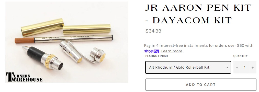

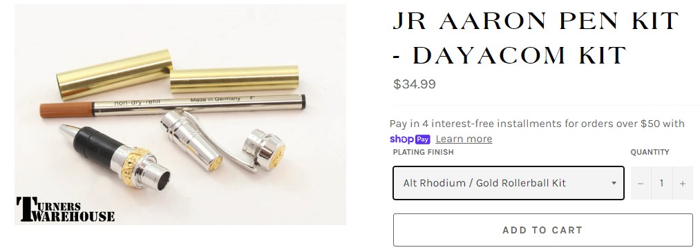

I am assuming ALT, stands for alternate. Does anyone know anything about this plating?

I know, but this says "Alt Rhodium". Most rhodium has disappeared from the pen making kits for awhile now, due to the insane price increase of it. My question is, what is ALT Rhodium?
The price of Rhodium continues to rise like all elements in the Platinum group so alternatives (ALT?) are being introduced. One I found is called PTLUX. It is advertised as an alternative (ALT?) to Rhodium. Betcha there are others.

Curious about this, I did some searching. Only other time I came across Altrhodium was on a german site, where...I think it might mean "fine rhodium"? I'm skeptical though...

It is interesting...I've found a number of jewelry items listed as "rhodium alt" or "rhodium finish alt". I am not sure if alt is actually a part of the plating designation or not, honestly.
I am wondering if this has to do with exactly how the plating is applied. At least for jewelry, and this may differ from pens, there seem to be some accepted ways of applying the plating. It is mostly electroplated (not as good as sputtering), and there can be different "underplatings" that are recommended. Some jewelers seem to always recommend an underplating of gold, topped by nickel, before the rhodium itself. This apparently produces a better and more durable bonding overall, since the layers are just electroplated and not sputtered. Another combination is yellow gold and sterling silver, overplated in rhodium.
I wonder if alt rhodium has to do with how it is plated. Not knowing if alt rhodium is better or worse (more costly or cheaper) than regular rhodium plating, I guess it could go both ways. Maybe its a more durable approach to plating? Perhaps its a less reliable approach... :\
Has anyone made a pen that carried the alt rhodium designation? I honestly had never seen it listed anywhere before today. It looks good in the picture, but we all know pictures can sometimes be deceiving and they cannot divulge anything about durability.
No one has answered. All guesses. Ed from Exotics needs to step up to the plate and if he has answers to what is happening with platings these days. He has so many customers from here that he needs to help us information wise. I know these are Dayacom kits but he deals with them also Psi is introducing new coatings. These new coating have alot to do with the fact with the war we can not get many different metals. Also prices are through the roof if you can get them. What are we looking at, what are the differences, what are the downfalls, and are the prices reflective to the material in use? Questions that need answering and not guesses.
There are a host of alternatives for Rhodium when it comes to decorative properties (in contrast to physical/chemical properties). For example, Bright Palladium which although is still very expensive, is less expensive than Rhodium. It plates pretty much the same as Rhodium and gives a similar tarnish free, bright white metal finish. The same is true for some Platinum & Ruthenium based plating solutions and some that are Platinum/Rhodium alloys. Of course straight Palladium or Platinum can also stand in for Rhodium, but I would assume that they would be marketed as what they are instead of Alt Rhodium.
I know it doesn't answer your question specifically, but I think John T. is correct that a more definitive answer must come from someone closer to the manufacturer (Dayacom).

I searched the Dayacom website and although they list that plating on some of their pens, I dont find any information specifically about the plating.

After reading this thread, I emailed Dayacom asking "what is alt rhodium?" and received this reply from an assistant manager:
"Alternative rhodium plating solution is describe as follows:
This plating solution is composed of special formula which can make plated parts with unique white luster and
can improve corrosion resistance. It's means this plating solution not only increase the hardness but also increase
covering properties of plated parts, therefore, it is not easy to fade or peel off. Suitable for using on high-end jewelry, premium eyeglasses frames and various components. Especially advanced countries like Europe is prohibit nickel plating that is sensitive to the skin, this problem can be easily solved by replacing the nickel layer with alternative rhodium plating solution."
So there you have it…a special formula. If Dayacom knows what it is, they're not sharing it with your average shlep like me. 😀
