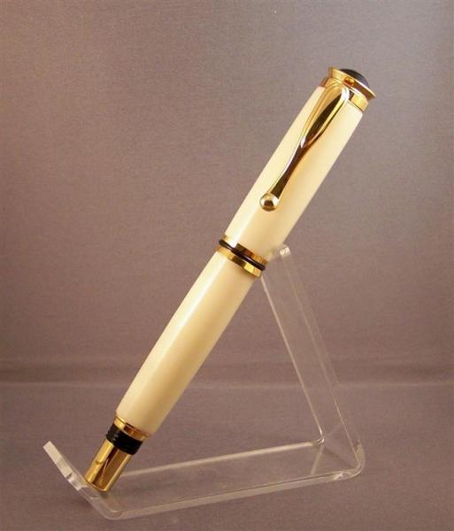

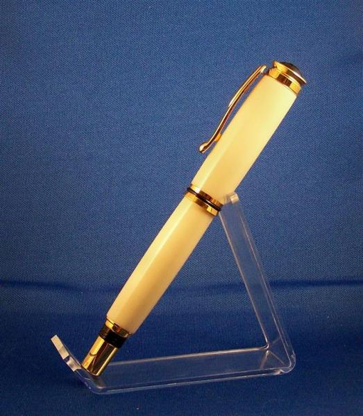

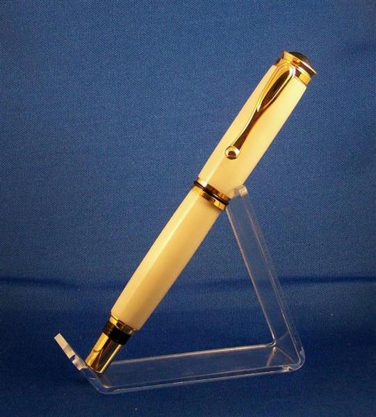

Another kit that comes from Exotic.
The Alt Ivory is also a blank from those two fine people.
Does anyone have a pic taking suggestion to get grain of the ivory to show up better?

Really beautiful work.
For the grain showing, try to under expose one stop then two stops. This will darken the pen. My camera will automatically take a series of shots a given amount apart and splice them together. For this to work, the camera should be on a fixed surface, ie. tripod. Otherwise, your photos look real good, even lighting, hidden or subdued shadows and well focused. Keep up the good work and practice the camera work.
PM me if I can help with photos.
Charles

I think your pictures are GREAT, Jerry!!
Makes the gold look gold and the ivory look warm(ish).
Certainly should be an easy pen to sell!!!
I'm not familiar with the look of Alt Ivory in person, so I can't picture what the grain might look like, but if you're going to be at the Turning for Troops and want to bring it along, I can bring my camera and a few diffusers/reflectors and we can play around a bit and see if we can get it to show better.
The blue background makes the blank look significantly warmer, not sure if the white or blue shots are closer to what you think it looks like in person, but I do know how difficult it can be to see slight variations in such light materials...
