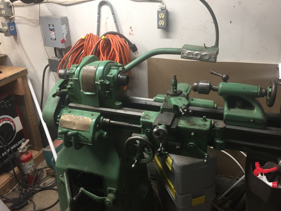

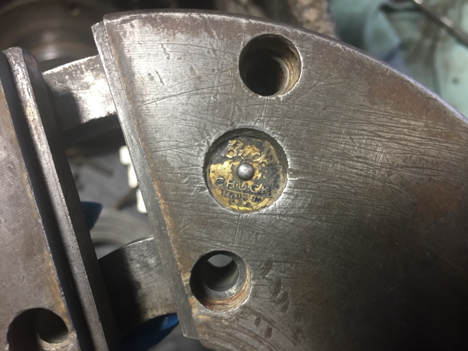

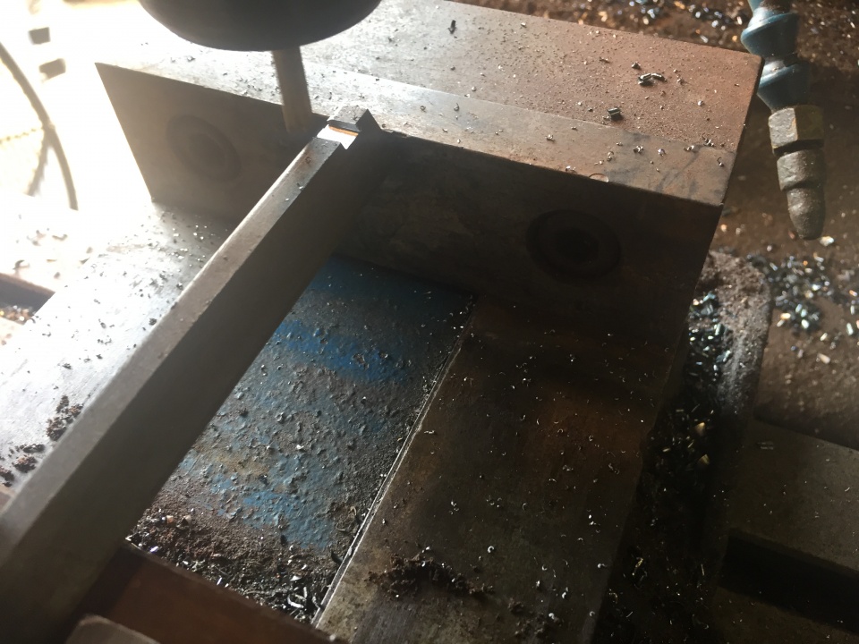

Been working on this heavy 10 for a couple of years now off and on (mostly off!). Getting closer to having it ready to play on. Have rebuilt the change gear box, the spindle has been welded and reground on the large bearing end, all new felts, near new half nuts, etc. Even got a new gib for the cross slide from Grizzly. Had to mill the slot in it for the screw head. Cleaning up the chuck and will likely grind the jaws. Just need a new belt to replace the new belt I had made, but didn't account for the old one stretching, so it ended up being about 2" short.
