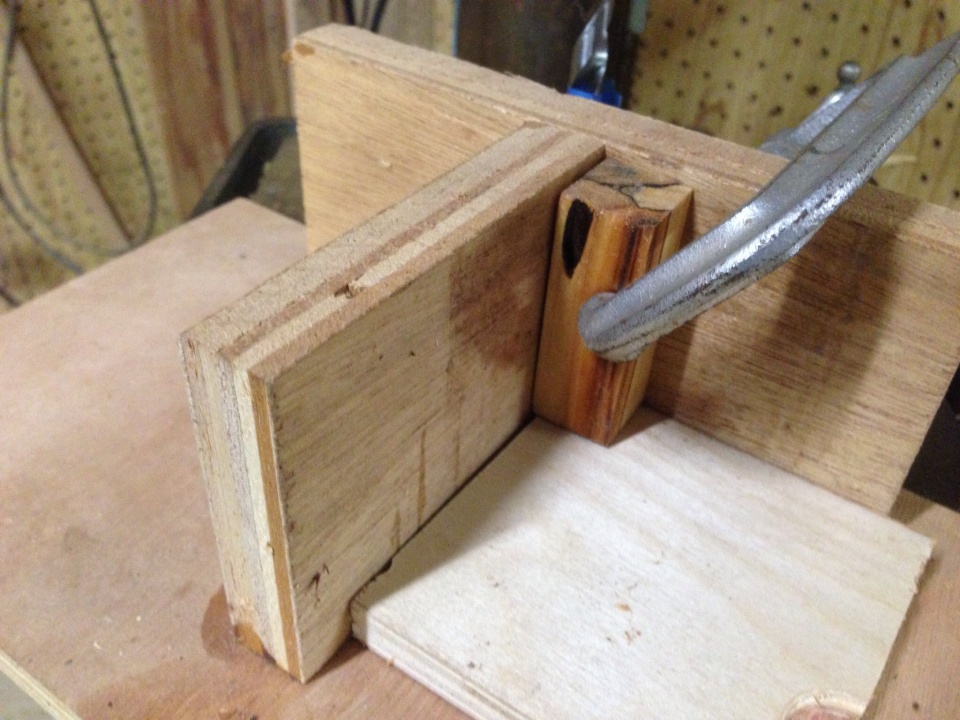

As an alternative to a pen drilling vise, you can make a simple jig similar to this. It's just a couple of pieces of plywood glued & screwed to a plywood base at right angles. I used this for my pen blank drilling for about 6 months before I got a drilling vise & I still use it for stopper blanks & such.
