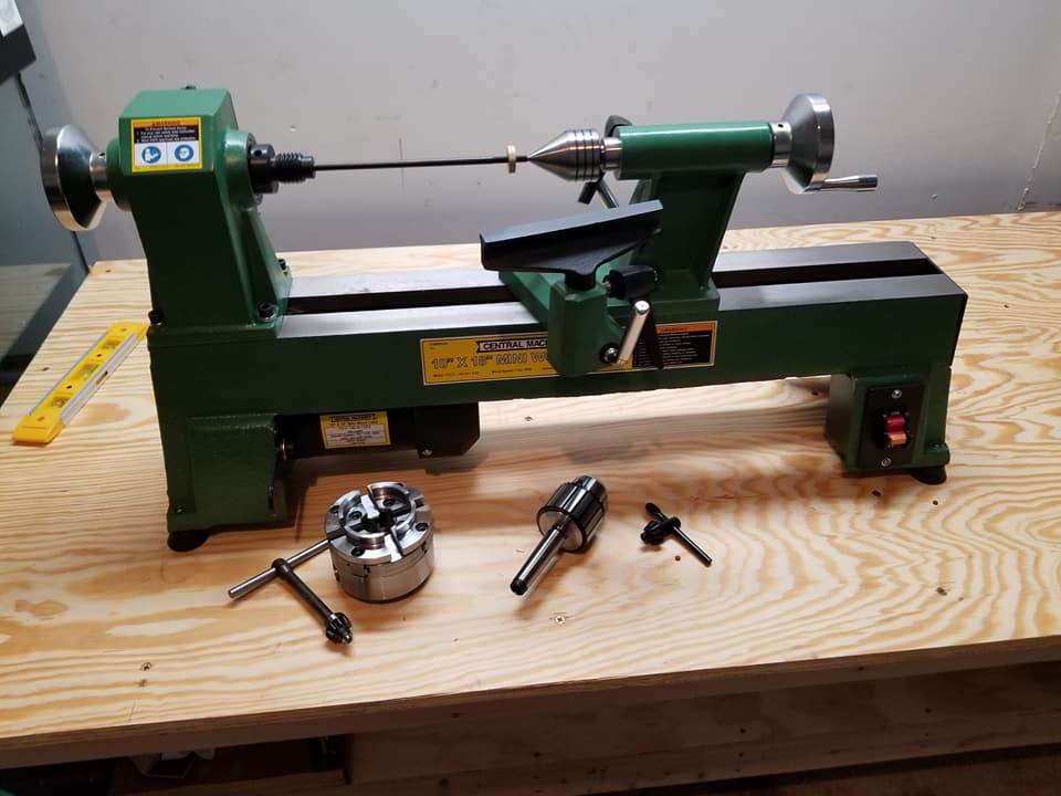

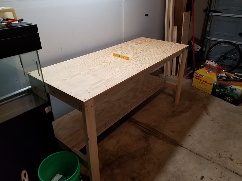

Spent the late afternoon, evening building the workbench. Got it finished and the lathe unboxed and almost ready. :) First wood going on lathe this weekend.
Not a bad little bench, height is a little tall for the lathe, so either going to cut the legs or build a step. I am 6'1 and the table top is 36" we'll see how I decide to go. I might just chop 2" off the legs before I get it fully loaded with stuff. :)

Nice looking bench and lathe !!
I would suggest that you try the lathe for height before you make any adjustments.
With your height, the 36" might be just what you need. Everybody has different needs.
If you do decide to make an adjustment, I would advise against a step. If it were in my shop, I know that I would find the step very annoying.
The most common height for a lathe is the spindle should be level with your elbow. I have mine slightly lower. The lathe should go close to the table edge where you are standing. You should bolt it down. This is recommended if you turn anything larger than bottle stopppers and even for those it is helpful. Hope this helps.

I am also 6'1" and have my mini lathe on a bench 1.5" lower than yours. I actually put a 2x4 under the lathe to raise it. If I used it a lot I would raise it more but it is a good height when other people come over.
My main lathe, a PM3520b has the Spindle height at 47". I have raised the lathe by 3" using 2x4's. I consider this a minimum height. If I did mostly Spindle work I would raise it more but I do mostly bowl work on it and with large bowls it will feel to close to my face if it is higher.
You do not want to be bending over as you turn. Your back will not like it.
Elbow height is a rule of thumb but each person will have a comfortable lathe height. Bending over will put a lot of stress on the back. The older one gets, the more it becomes a problem.
A big no to the step. Just an accident waiting to happen. It's easier to raise a table than lower it. Try it like you have it and add blocks if needed.

Thank you for the input. I will wait and see how it functions before changing anything. My observations were based on just standing next to it and comparing how my setup was before and it was a little lower, as I didnt have to lift my shoulder to drop the tool into the spindle as much.
As for the bech, thank you, it is not bad for a basic 2x4 build, I used a plan from the internet, But will be adding some design changes to it as the days progress, tool holder, mount for the grinder on the right etc.
Just needed something to start with and build off for now.
