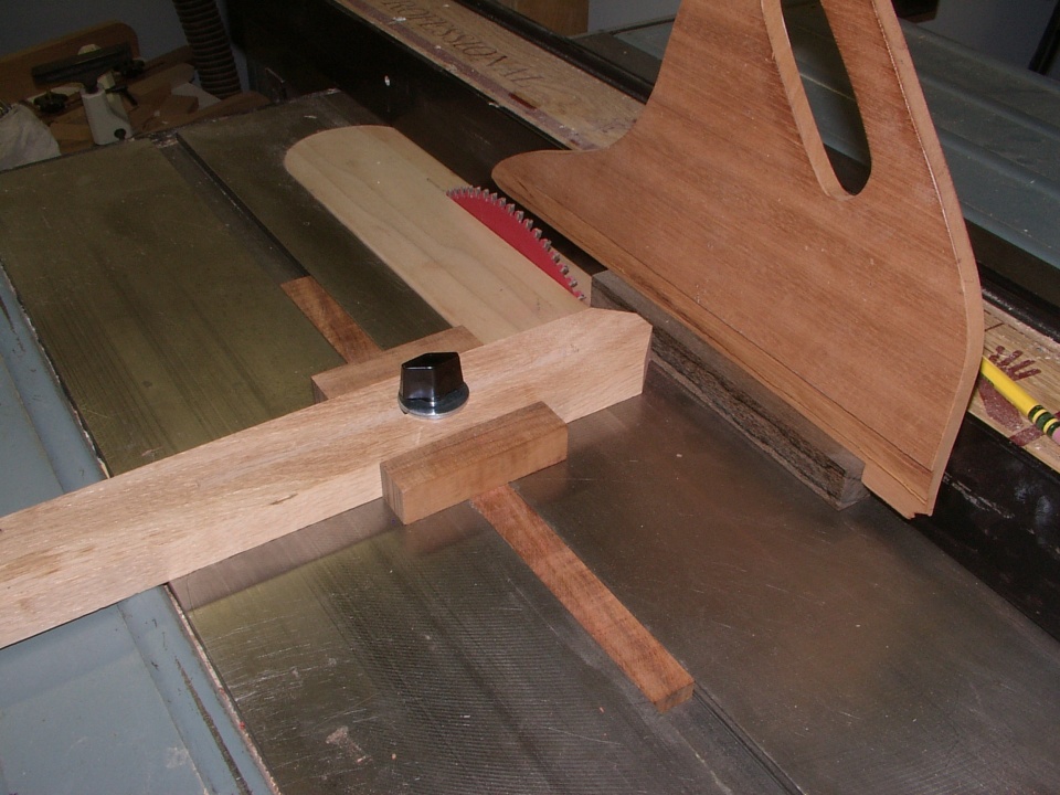

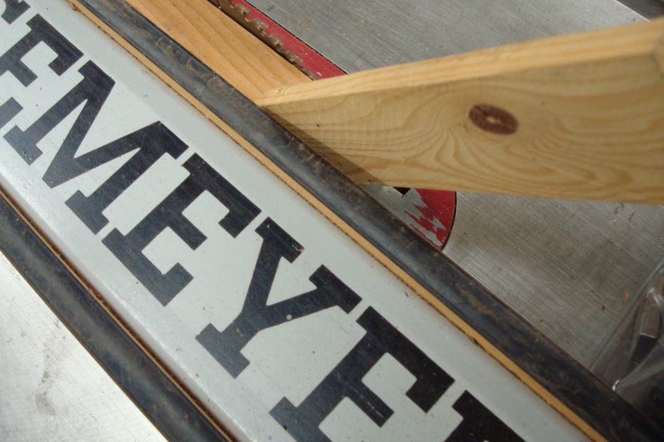

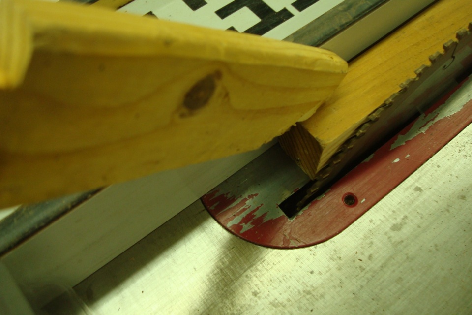

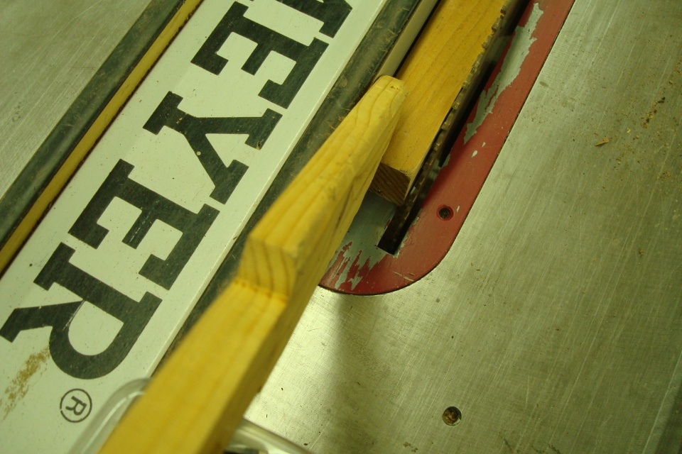

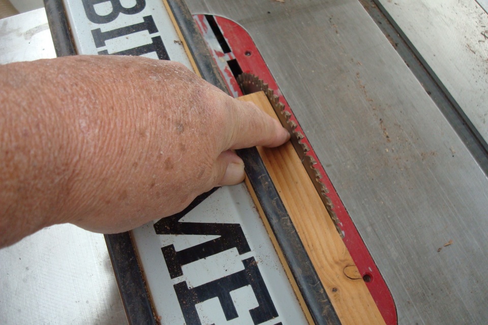

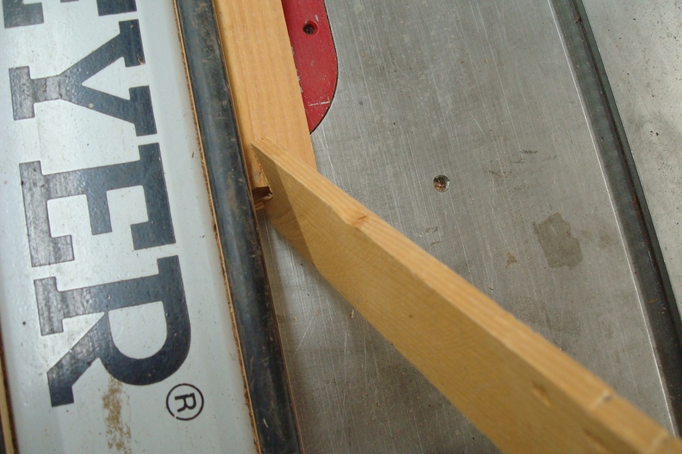

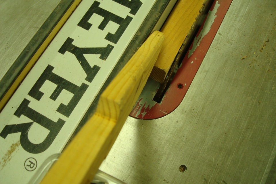

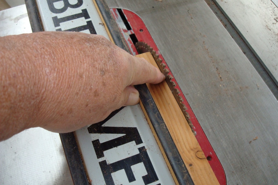

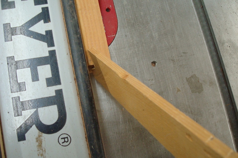

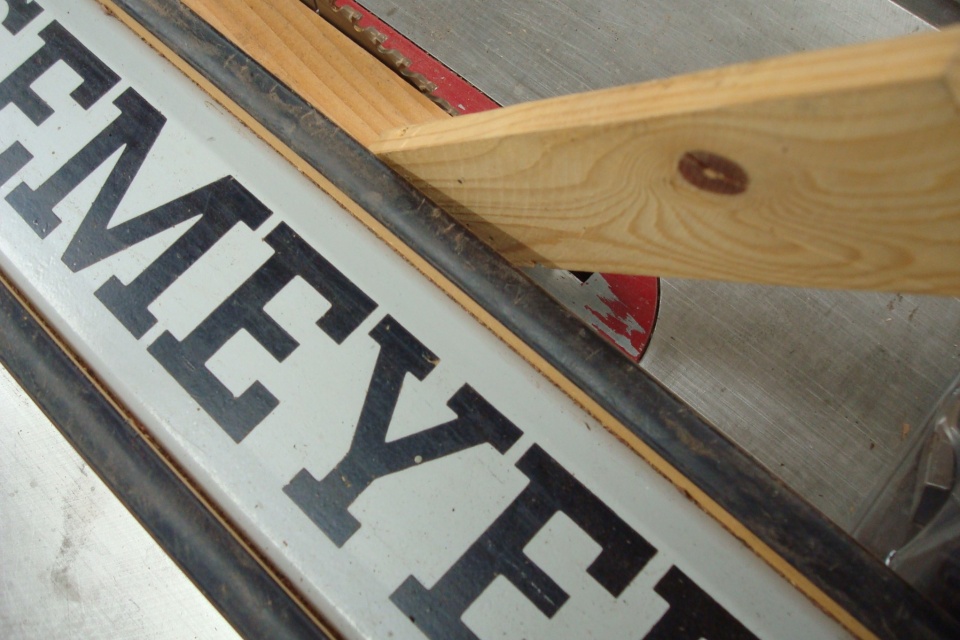

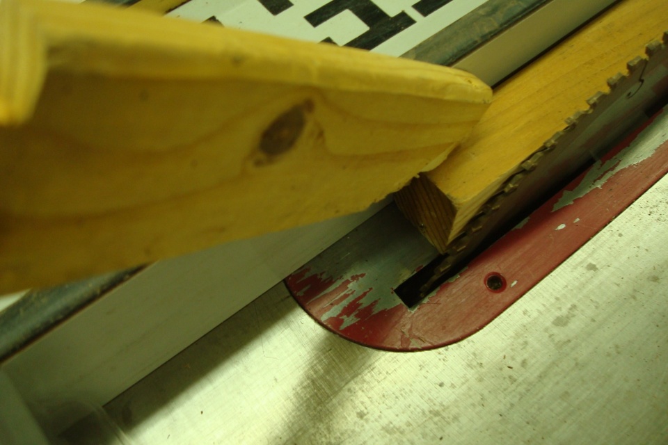

A couple of days ago. I was ripping 1" strips on my table saw. I use my right hand & the push stick and my left hand pointing finger. I put my finger on the wood between the blade and the fence about center of blade and rip.
I started the cut and about half way I felt the end of my pointing finger getting hot. I looked and the end of my finger was on the blade but below the blades teeth. It was just rubbing against the flat surface. I moved my finger back a little and finished the cut and looked at my finger and there was a very tiny piece of skin and my finger was a little red. It was hot.
Back to the drawing board, I know what I should have been doing.
I don't have a TV, phone or radio to distract, I just moved my finger to far and almost.
Preston

:eek: See that red area around the blade? Fingers should never. ever, ever, under any circumstances be in that area while the saw is plugged in. :doctor:
It is always good to see a reminder about basic shop safety every once an awhile. I'm glad you were not hurt!!
This little device cost about the same as an office visit to a doctor, and much less than a trip to the ER.
https://www.amazon.com/GRR-RIPPER-P...r=8-1-spons&keywords=gripper+push+block&psc=1 :wink:
Why do you have the fence on the left side of the blade? Normally for a right handed person the fence is to the right of the blade. Cutting like that would to me be awkward.
Perhaps you need to make some feather boards to hold the wood down.
If I had done that with the SawStop the brake would have triggered.
I'll add that it is good of you to show people how they could get into trouble doing such a thing. Thanks. Most would shut up and not allow themselves to be embarrassed.

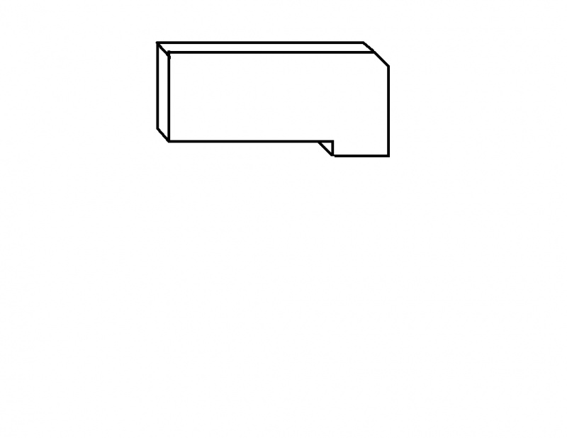

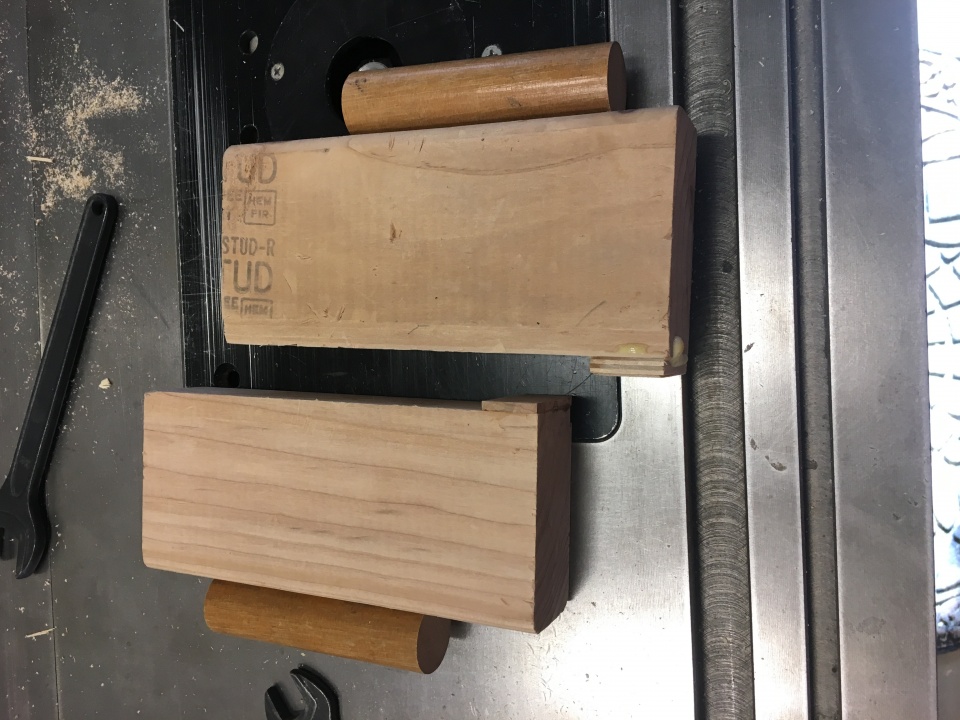

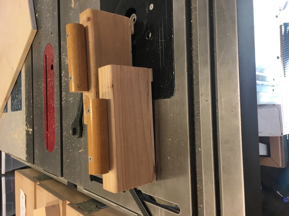

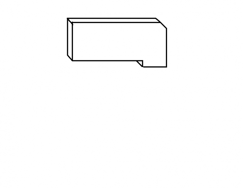

Here's a device that works really well for me. Saw this years ago on a woodworking site and have made a lot of them.
WB
Oh, forgot, make these from a 10 or 12 in. piece of 2 x 6. It straddles the blade so you push both cut pieces through at once so no kick back and fingers out of the line of fire.
WB

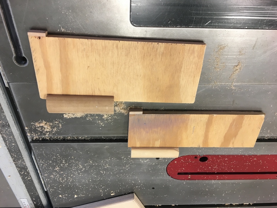

I've got a pair of grippers, but my 2 x 6 pieces like Butcher's are what I trust most of the time. Takes 30 seconds to make on a bandsaw, then as they wear, I trim a few times, then they find another use and the whole thing begins again.
earl
Preston you are asking for trouble many ways to Sunday with that set up. First rule is never get complacent working around power tools. Just because you have done things 1000 of times does not mean you will not have a problem. Always be aware of problems.
Second thing is the fence on a tablesaw is always set up on the side of your dominant hand. That is the hand that will push the wood past the blade. You always push the wood both against the fence and through the blade on the fence side. Never put finger between the fence and blade. If any sort of kick back your finger is trapped both left and right.
Always use a push block. I have shown ones that are so easy to make and I I have many of them around. After awhile the blade will tear away too much of the hold down area so you just recut a new shoe hold. Look at the push block and you will notice a couple things. The hole to grip the push block is large and high enough it is always keeps your fingers away from the blade. You never raise the blade more than 4 teeth above the material you are cutting. The push block is long so that you are actually pushing down on the front of the material as the foot on the back end catches edge of material. I have used these type push blocks for many years and they have served me well in design and function. The addition of feather boards is also a good idea along with a riving knife on back end to prevent pinching of boards if there is internal stress in the board and prevents kick backs.
The only time you reverse the fence is if you have a right tilting blade and then you swing to other side. This goes for if you are left handed too the same rules will apply.
Being safe around a tablesaw or any power tool will require your attention and knowledge of that tool. Safe sawing.
I'm one of those where either Left or right handed is OK. Sometimes I rip on the left and sometimes I rip on the right.
I don't mind showing if it helps someone then its all for the better.
Preston

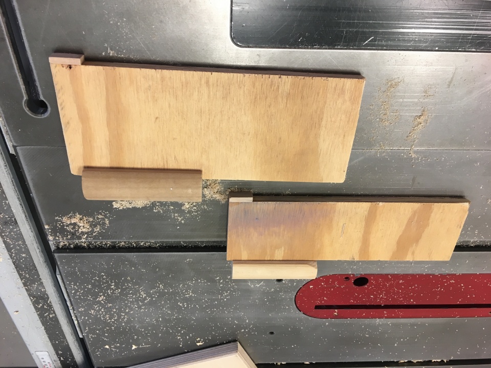

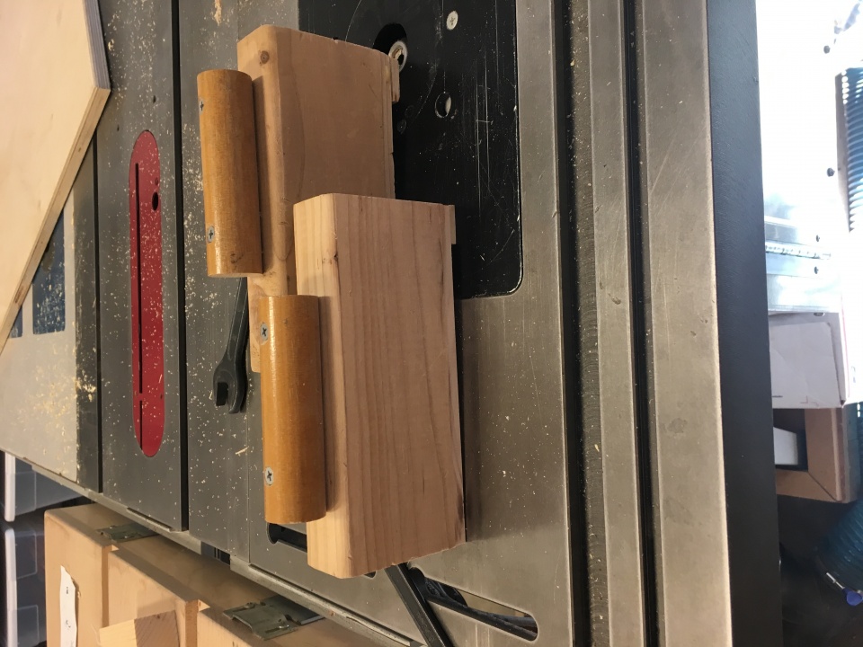

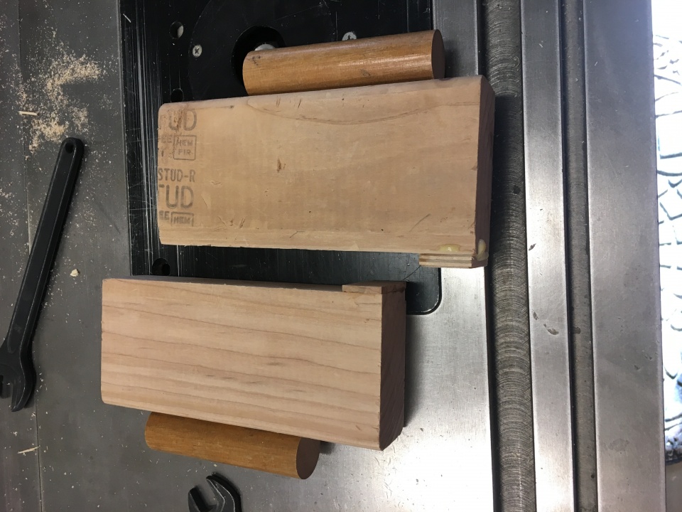

Push sticks made easy
Please make these and save your precious fingers. These let me cut strips as thin as 1/16" safely with my precious fingers inches from my blades.
