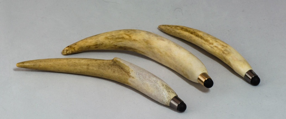

I've drilled at my lathe (and even have the pen drilling chuck) but some things have to be done at the drill press. I find it very easy to set up antler tips for drilling at the drill press for pens like the first picture here....and for the trio of styluses as well.
I have a pen drilling vise for my drill press that's much easier to dial in and my drill press has almost five inches of quill travel so deep drilling is far easier on the drill press than on my mini-lathe (where the tail stock can travel only a couple inches and the feed rate is far too slow...so I end up pushing/pulling the tailstock to get faster feed rates which can cause problems if the tailstock isn't semi snugged down...too much side play).
For those on a limited budget or with limited floor space, being able to drill at the lathe is very handy.
