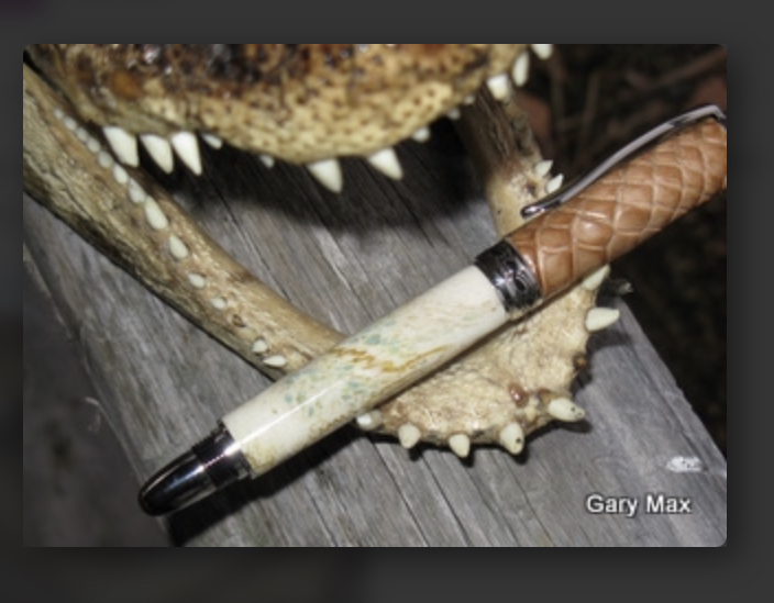

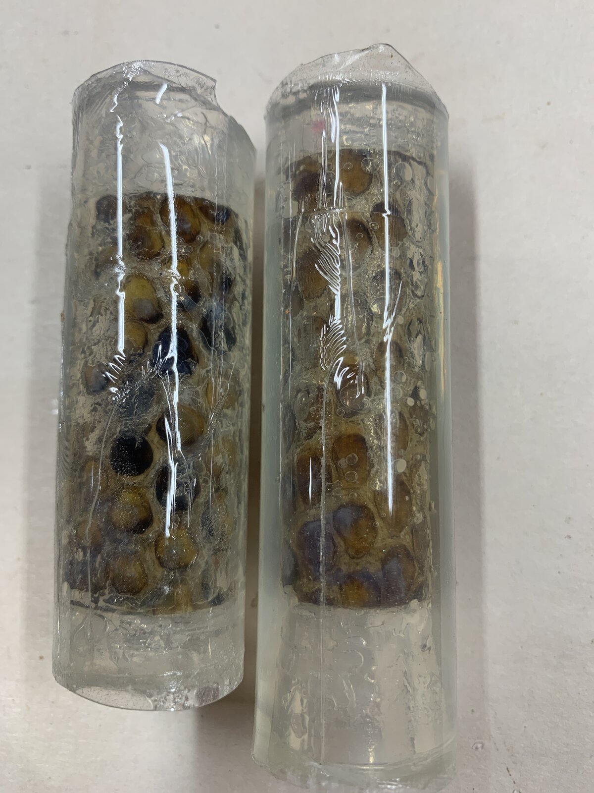

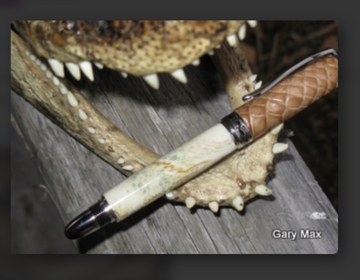

I tried some recently from some scraps I had. As Kenny said, it was thick. I sanded the back to fit the space needed, glued it up and the leather surface reacted to the resin. I'll try again but it looked much better before cast. I remember Robert Snowden aka "Snowman56" here, made some years ago (back in 2007). He made jrs with a cast gator jawbone for the lower and the top was left leather and not cast.to my recollection, he was the first to cast gator jawbone. Here's a pic of my failure and his success.

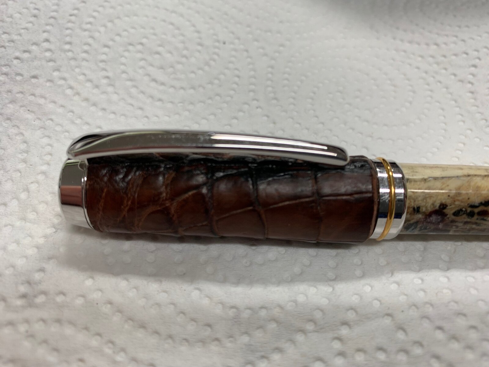

ed4copies
Local Chapter Manager
Mar 25, 2005
24,531
Racine, WI, USA.
As John mentioned, Robert Snowden did a lot with alligator bones and some work with skins.
I purchased this pen from him, over a decade ago--but it has been stored, not used.
Awfully pretty work!!!!

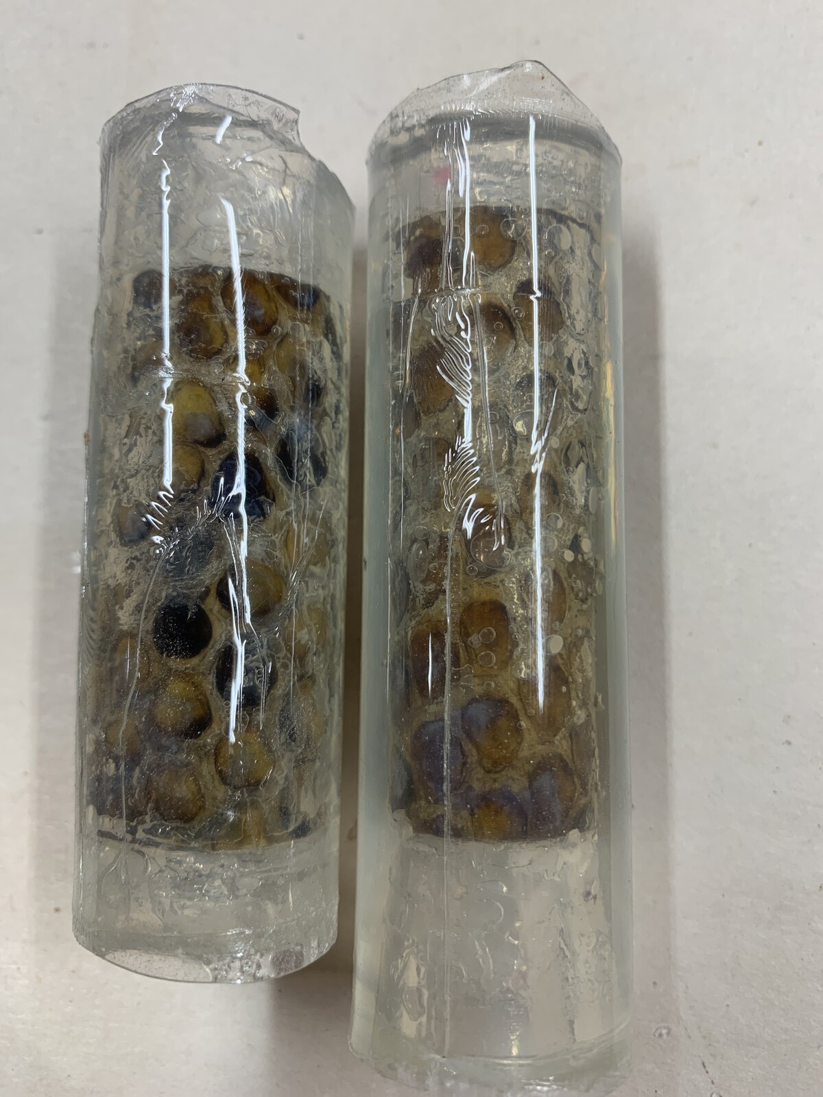

Jul 13, 2020
9
New Castle De

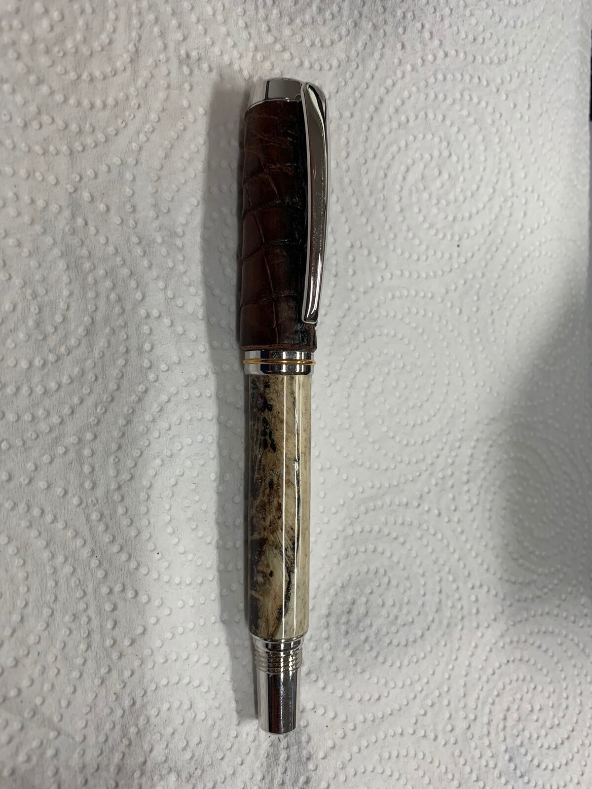

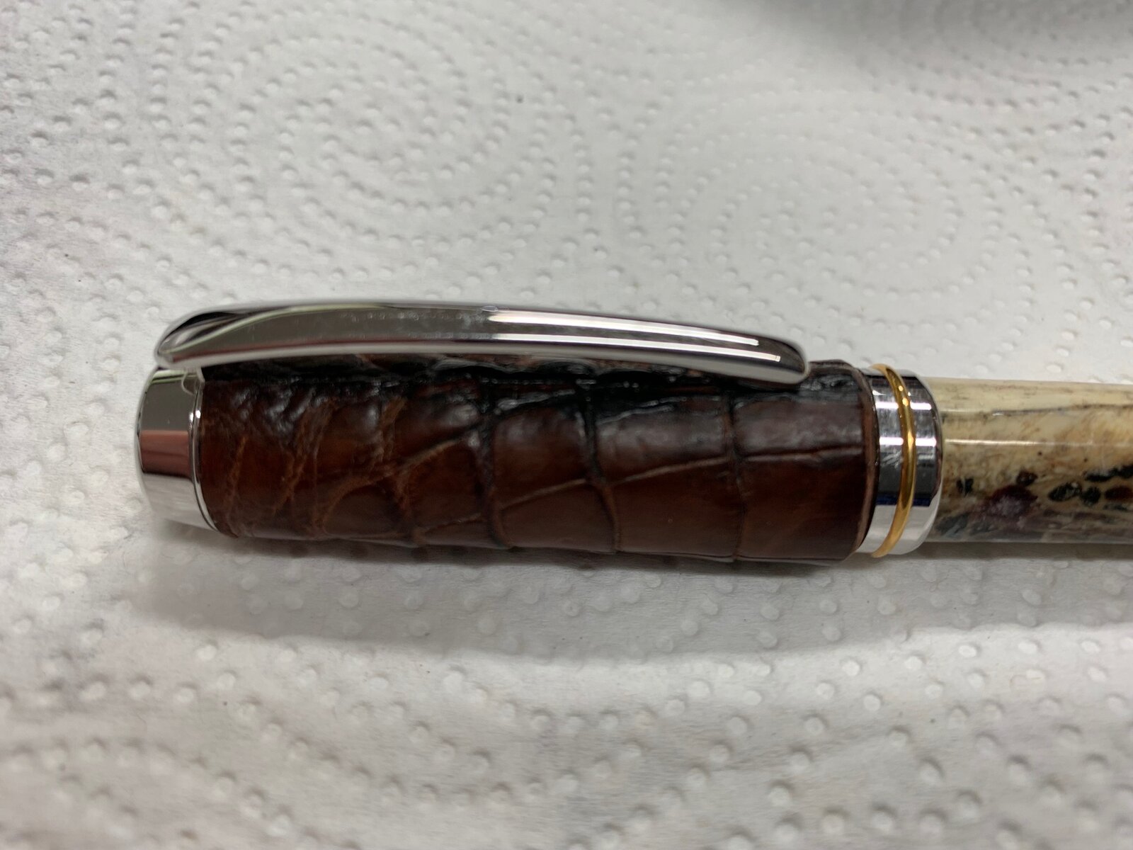

Here's an update...
The hide was thinned as much as possible. Double sided carpet tale was then used to stretch & attach the hide. Thread was then wrapped around the hide overnight to insure a good glue bond. The thread was then removed. 4 coats of color preserver was then painted onto the skin. This displaces any potential air pockets in the hide. The tube was then painted with 3 coats of epoxy & rotated until dry. I'll try to post some pictures tomorrow.
