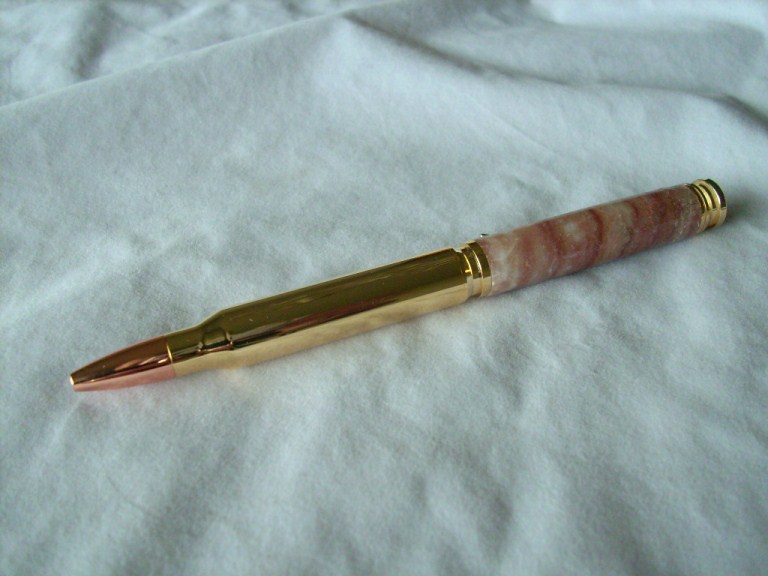

Did a soapstone cartridge pen last year...beautiful!!! But since it has no tolerance for expansion, there were little fractures after the parts were pressed. Turned a new barrel and honed the inside of the tube, epoxied the parts and that solved the problem.

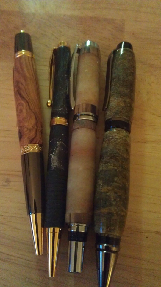

Use gorilla glue
And use a kit that leaves a lot of material. Alabaster will not hold up to kit less. I had to repair mine before I had a chance to pull it off the lathe. My soapstone came out good.
