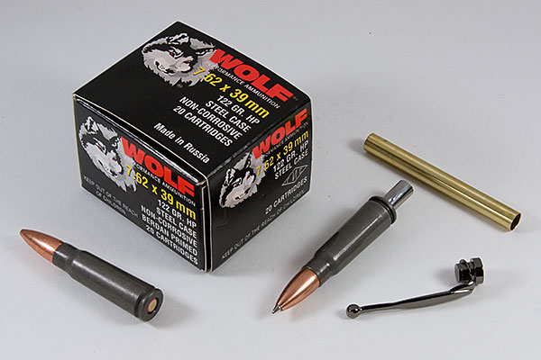

Don,
Here is what I can make from some ammunition I have. As I said in my pm, if you want traditional brass, I'll have to order components.
This sample kit uses a 7.62x39 lacquered steel case, .310 bullet, mini-refill, long brass tube (because the cartridge is short), and black chrome (a.k.a. "gunmetal") clip and finial.
