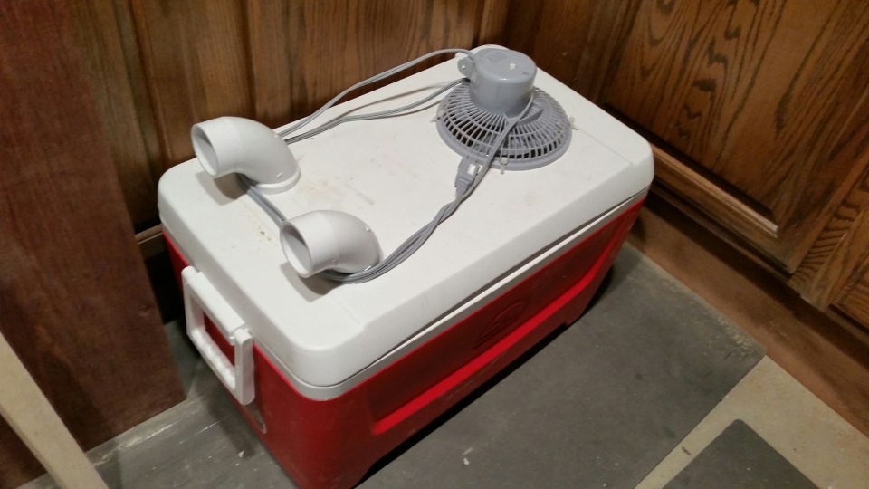

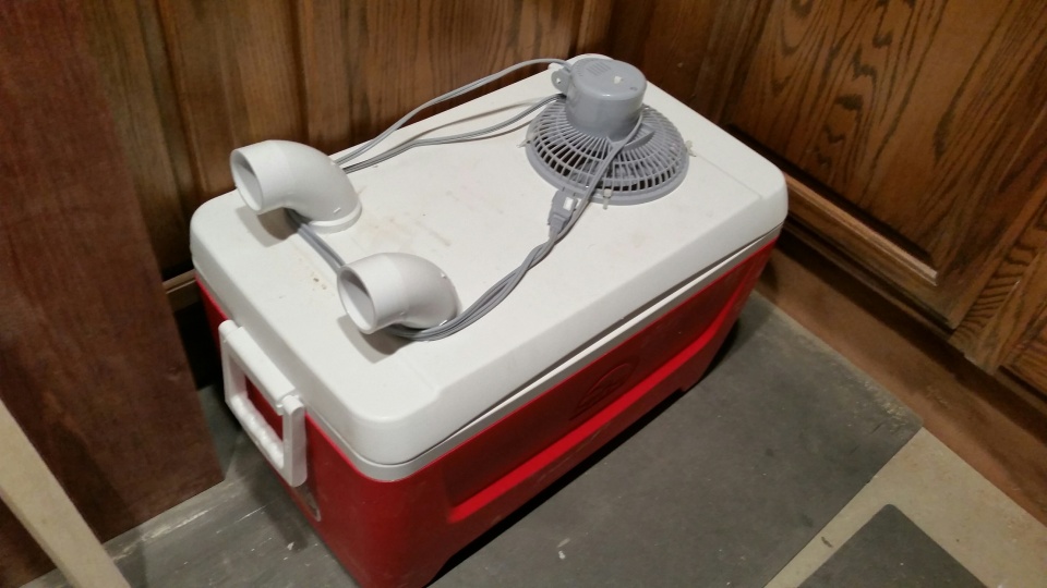

Here's my solution, I hope. I got the idea on You Tube and found the 48qt cooler at Wallyworld for $15 and the fan for $10. Add a few bucks for the PVC elbows and about 30 minutes work and wala. I have frozen a bunch of drinking water bottles and will but them in the cooler and turn the fan on. The test run shower output air at around 45 degrees and the cooler wasn't full of the bottles. My shop is about 14 x 24 and very well insulated so I'm hoping it will allow me to stay out there for a few more hours. Why not!

Who would have thought it was this simple!....Ya know...if you make those up and put online, there are folks at will buy it!
Can one still buy a block of ice to put in front of a fan like they used to do?

Yeah Charlie, I thought about buying bags of ice but then you have the water to deal with and you have to rebuy it when it melts. I'm using 22 oz. water bottles that we have emptied and I have refilled, it will give me "free" ice that I can get any time. I also figure that the more surface area for the air to pass over the better it will cool. That has yet to be proven but hey, less than $30 bucks and....it's totally portable. Not that I ever "wood" but, one could place beverages in with the ice and have a refresher when needed and one for after work is done.
