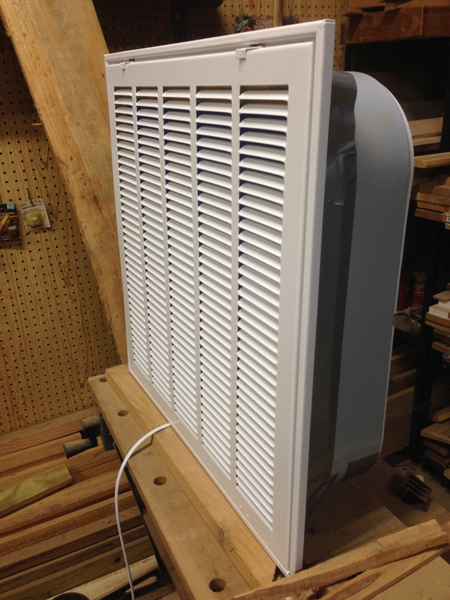

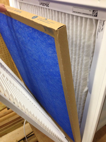

Here's my air cleaner - about $75 including the filters.
Replacement filters run about $20

Edgar can you explain what you did it looks like a big 24 " fan with with filters
That's basically it - but it's a 20" fan with a 20" filter grill duct taped to the back to make filter changeout easy. There's room to put two filters in the grill housing so I use a cheapo filter to catch the big stuff and a better filter to catch small stuff.
I use the best filter I can buy at Home Depot - it's got a 1 micron rating.
Honeywell 20 in. x 20 in. x 1 in. Ultimate Allergen Pleated Air Filter-91001.012020 at The Home Depot
Edgar
