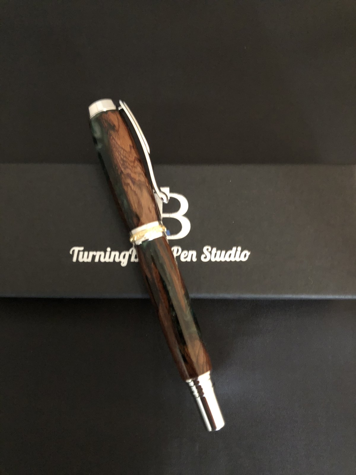

Folks - I followed eat wood and paint a light coat of clear on the wood - let cure overnight
2.Heat wood and mold - up to about 175
3. Mix and pour 3 colors of alumilite into mold with manzanita.
4. NO bubbles and beautiful bond between wood and acrylic!
5. picture will be forth coming!
thank you all very much!
Keith
Here is the pen from this last cast! JR Statesman RB with Manzanita with alumilite clear
