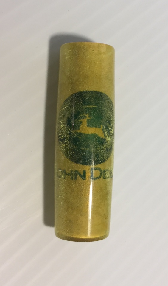

I cast this the other day for a guy. When I turned it, it had air bubbles all around the decal. What am I doing wrong? I used spray on mod podge. I sprayed it a few times letting it dry between. I poured and put it in my pressure pot on 70 lb of pressure. I don't know.

Alumilite or PR? If you seal the blank with Mod Podge (water based) and use Alumilite, you need to give the Mod Podge plenty of time to cure. I quit using the stuff and switched to a laser printer due to hazy spots.
I don't have much experience with PR but the blanks I have done with the stuff have come out close to flawless as long as I use the right amount of catalyst and use a slow figure 8 stirring motion.
Other issues especially with Alumilite could be ambient temperature, moisture in the air, finger oils/grease on the blank surface, etc.
My guess though looking at the blank was my first answer in the fact that the Mod Podge didn't have enough time to cure properly or the mod Podge layer was not smooth and created little ridges and such that the resin could not fill?
I use silmar 41. And the cure time could be right. I sprayed it that morning and poured it that night. I'll try again and let it cure for a couple days. Thanks for the reply.
