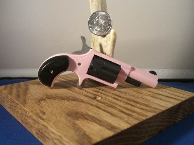

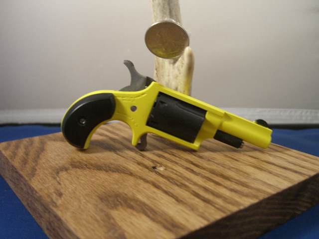

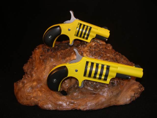

I use one on a daily basis doing the dura coat service on guns. You could use any paint as long as it is thin enough to go through the gun. If you check online you will find a ton of videos on how to get started and basic airbrush techniques.

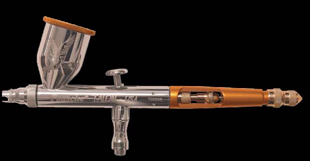

I have the HF 6 brush set that I was going to sell on here. The one I have grown quite fond of is my new Paasche Talon. It was $80.00 but well worth it.
My airbrush and some of the work I have done..
