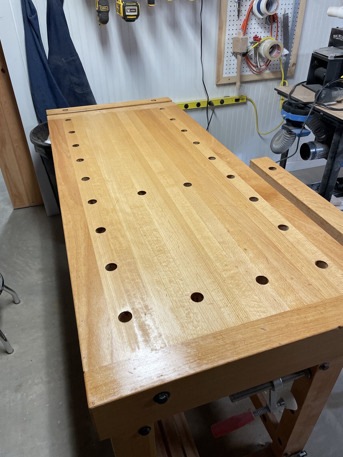

Ain’t she pretty 😁

Been awhile, sanded her down and gave her a couple coats of BLO. Should be dry and ready to go in a couple of days.

Thats a really great bench Ken. Do you plug the dog holes with foam when not in use? I found that a useful tip with mine. End vice too, nice feature. I installed one but have never yet used it , then again that would mean moving the pile of sash clamps that lean on it in the corner....

I have never plugged the holes. May I ask the purpose of plugging them.

Stops router shavings, saw dust, small nails etc dissapearing into the holes only to re emerge when I'm painting or staining a piece.
when something gets knocked onto the bench when the dust etc jets up into the air to stick to the wet work !
makes vacuuming up from the worktop a cinch too.
You use a bit of wire hooked to extract the foam plug from the hole you wish to use each time.

Sounds like a good tip.
