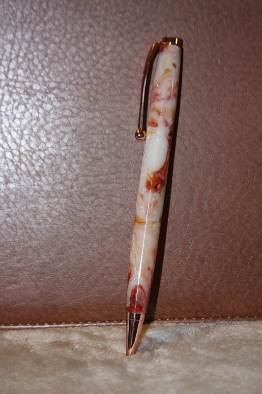

I am very new at Pen turning. I have only used slimline kits. They are coming out decent. I would like to try a different style pen but am limited as to cash to buy the bits and bushings. So I'm kind of snookered.
What would be the most universal drill size and bushings to attempt a different style pen? or pens? I do have an ok drill index but lack the metric sizes.
I am not a cheapskate, rather in a financial state that limits my "luxury/entertainment" budget.
Any solid input from this forum would be greatly appreciated.
If this is in the wrong place, please forgive my ignorance.
And thank you to everyone for all of your wonderful input throughout this site--you make a difference!

That's a nice looking pen ! . A slimline without a center band ? . How do you change refills ?
OK, so what's the next step for you ? . Well first off, don't think you are done with slimlines. . You will come back to them in the future . . They are pretty versatile.
In my opinion, the slimline is actually a harder pen kit to work with than the "next steps" that I am going to suggest.
The most universal tube size is probably 3/8" (based on the large number of PSI kits that use that tube size). . But bushings don't have the same universality, not even amongst the PSI kits.
I would say that the 27/64" tube is next (or some might say it should be first) because you find it in the Sierra, Sienna, Gatsby, Mesa, Virage, Pensar, Napoleon, Le Roi Click (and other LeRois), LeRoi Elegant Major, etc., etc.

magpens That's a nice looking pen ! . A slimline without a center band ? . How do you change refills ?
I followed and modified the instructions in the Library here on this Forum.
The nib/tube/transmission/refill all pull out the end rather easily in one piece to change the refill.

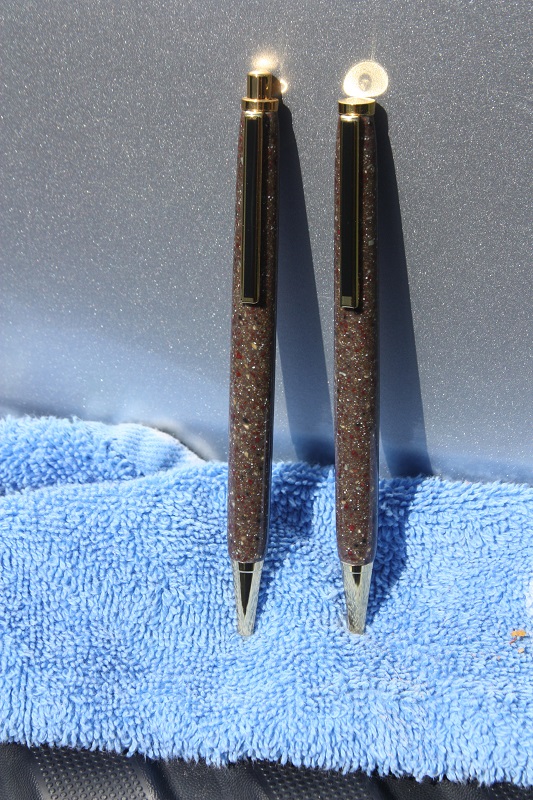

Nice job on the slims. I have made a few one piece slims with corian. Now if you want to test your drilling skills that is the way to do it. Drilling a 7MM wide 5" deep hole in half inch square corian and not blowing out the side is a challenge. But it sure shines up pretty. I just could never get use to turning the tip to open and close it and doing it one handed was a real pain.
Like these? LOL! Cordless drill and vise done by hand. Less than 5/8" blanks~very slowly and time consuming.
A lot of Corian is 1/2 inch isn't it fairly easy to glue 1/2 inch pieced together to get 1 in square blanks? If you did that wouldn't they be a lot easier to drill?
If I have learned one thing in this life it is this: "Patience is a virtue".
Quite possibly the only virtue I will ever attain. Life has thrown me many a curve and knuckleball, but like the Tortoise, I just keep plugging along.
The idea of gluing 4 together has been in my mind, I just worry that CA glue wouldn't keep a solid bond and I have had a bad time or six with epoxy, just saying. It may be in the future though, I just started this a short while back and if I were rich I could do so much more with better equipment and such. I think you guys would be shocked if you saw the rudimentary tools I use. I'm just thankful for what I have and for being able to do so from time to time. Thanks for the input!
