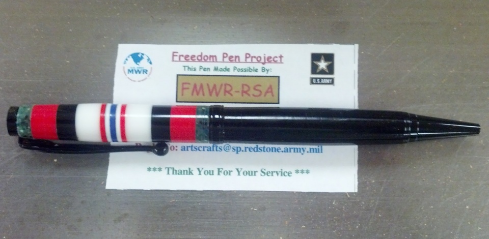

This pen was turned from Acrylic, Corian and guitar picks. The stripe thicknesses and colors were scaled to fit the Comfort pen tube length.
I made a couple of pens using dyed Poplar (Rit dye) but the dye wanted to reflow when applying spin shellac or CA glue. Eventually I used Carnauba wax and applied wax on a per stripe basis. The acrylics are nicer but cutting the thin pieces was tricky.
Many thanks to the Redstone MWR for hosting the Turn-A-Thons.

A Beautiful Pen Mike, For a Worthy Cause.
Love the Service Ribbon Segmentation, Terrific Fit and Finish.
Well matched to the Kit.
I look forward to future postings.

A truly outstanding pen. You idea for the making the service ribbon is great and your fit and finish is spot on. It's a very worthy cause and your pen is perfect.
