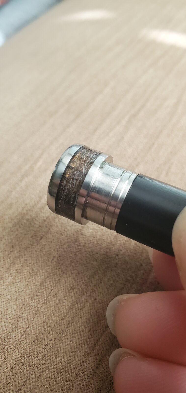

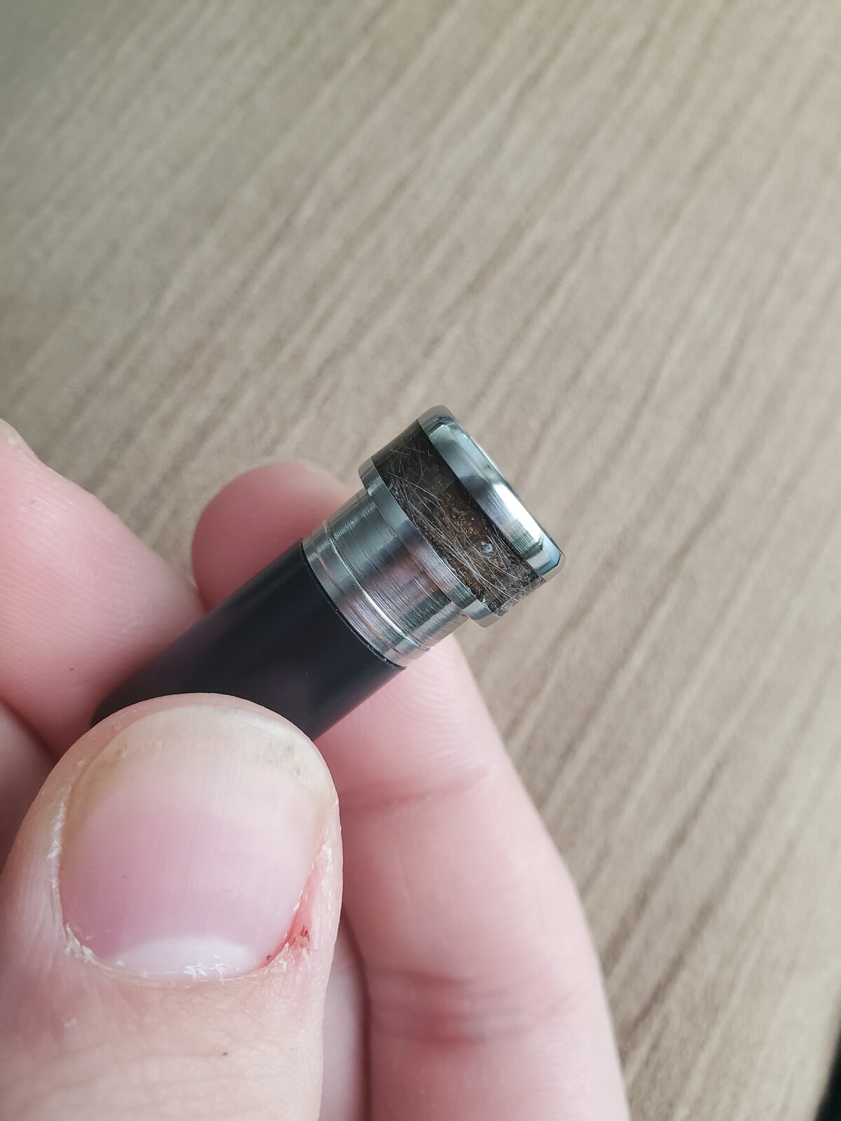

I'm using a "Band-It" rollerball kit from exotics, and just finished the centerband this weekend using smaller hairs from her previous horse. I used CA to adhere and seal the hairs, then UV resin to fill the rest of the channel. I've gotta say, I'm pretty happy with the results.

Looks great! Congrats..I'm very happy it worked for you. She's going to love it. I can see orders piling up for you once she shows it off.
