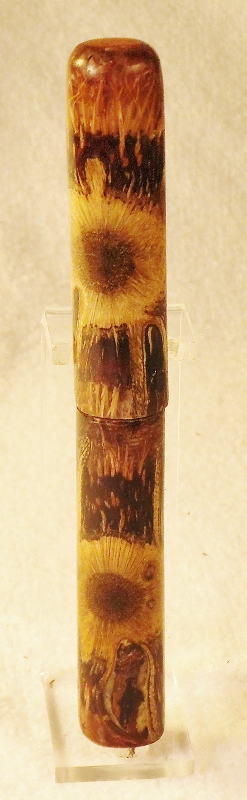

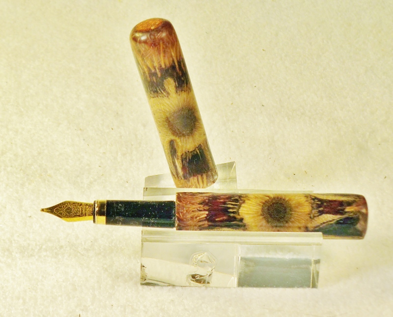

My advice to you would be to try a few acrylic pens first !!! Acrylic is more forgiving than wood when it comes to running threads. In wood, you need to have a very tight grain, sharp tools, and some prier knowledge in taping woods. Practice a little first before moving on. The same taps and dies can be used on wood, acrlic or metal. Only didderence is skill of the craftsman. I have inclosed a few photos of a pen I had made out of a Banksia Pod blank and Ebonite, that has been stableized by casting in resin by one of our members. George Valentine (robutacion) from Australia. I would suggest a good stabelized blank to work with. Jim S

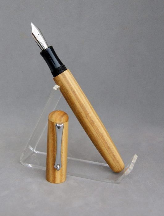

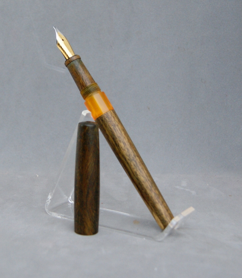

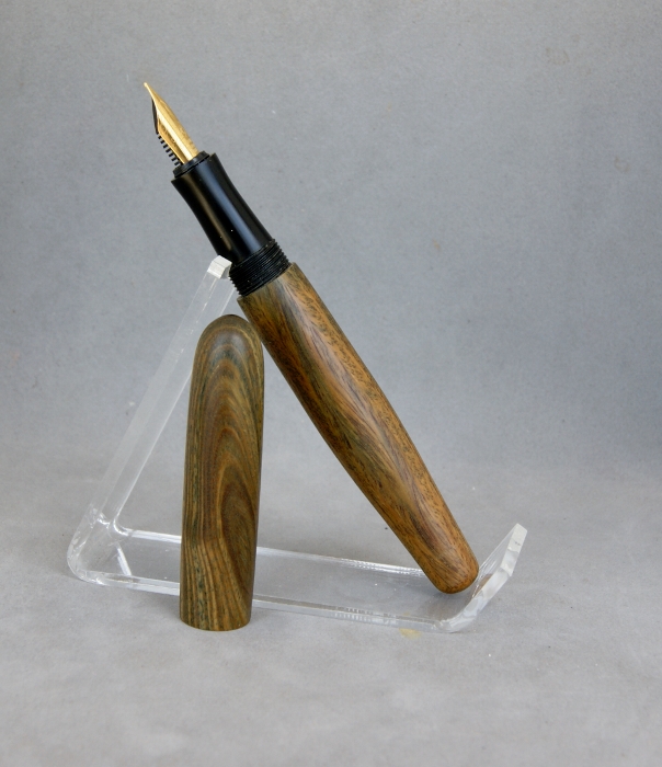

The biggest area of concern for an all wood pen would the be cap/body threads. That's where the wall thickness is the thinnest and where you put the most stress. I use either acrylic or ebonite for these threads just so I don't have to worry about it.
