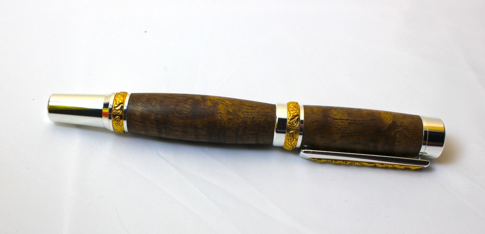

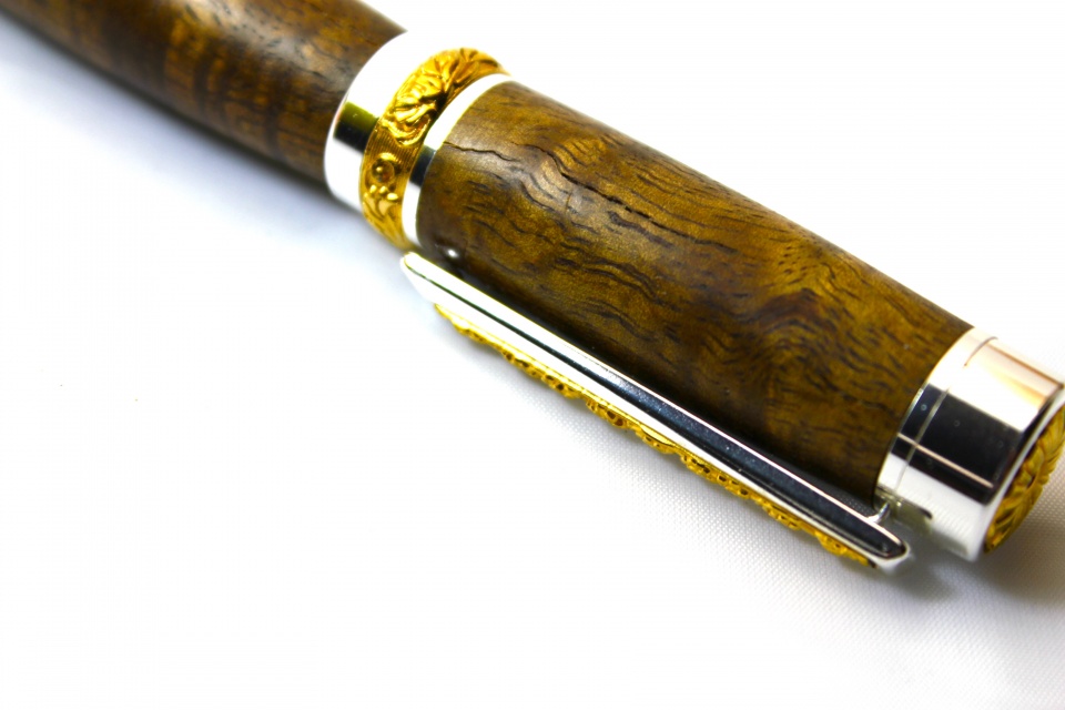

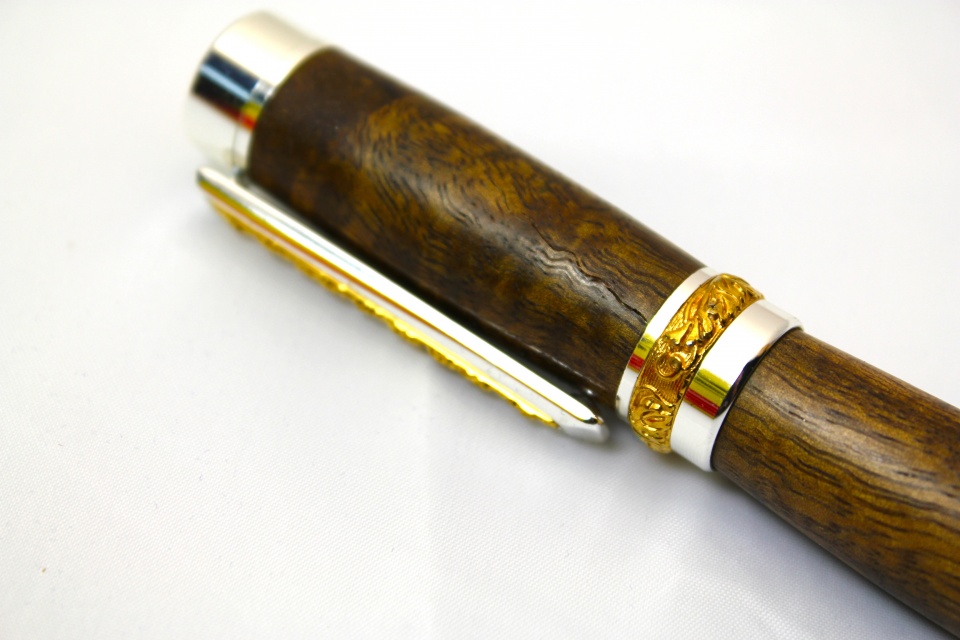

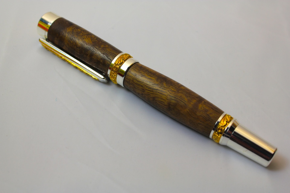

Hey Jeff -We need a Forum for "Pen First Aid"..:rolleyes:
Last October I turned 2 matching pens - gave one to Wifey and one to my brother.
This is wifey's pens - she's not complaining, she has about 40... she can match her clothing with a matching colored pen every day. :wink:
The wood was Figured Hawaiian Koa - Really nice chatoyance! And my turning was actually not bad. Finished with EEE and wax. (my skills with CA are just getting adequate).
I bought the wood directly from a vendor in Hawaii. So... the obvious is wood coming from Hawaii - to Ohio, then Ohio weather turning to -10 several times (very low humidity I assume). So my beautiful dry wood still went from high humidity to ultra low humidity... CRACK!!
I am open to suggestions. Yes, I can try to perfect CA finishing overnight and will try that if it's the best option. However - anything else? Wipe on Poly?
Thanks for the help.

My best guess at the approach you should take (with zero experience at doing it myself) , would be to dis-assemble the cap , strip the wax/EEE finish off with acetone or something like Polyclens on a rag , fill the crack with thin CA , then refinish in the same way as the original finish , unless you want to strip the entire pen and refinish with CA .
Oh , your humidity theory is 100% correct .
For cracks that wide, I press in fine sanding dust to help fill the void. I would expect that if you filled it with just CA, it'll still show under the finish since CA is clear. Packing the crack with fine sanding dust makes the crack look like grain (especially if you use a species that will turn dark when hit with the CA…experiment on scrap first).
Ebony dust, for example, would make that crack dark. You can find woods that will stay light when hit with the CA which would make the crack stand out (which in this case likely is not what you want…just mentioning that as an option for future reference).
If the crack is wide enough, pack in some turquoise inlace for a thin vein of cool color. It's not a defect, it's a design challenge. :biggrin:
