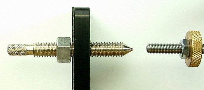

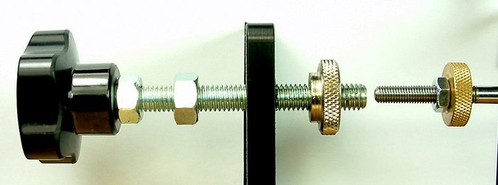

First thing I did with my Pen Wizard was extend the threads either end of the mandrel to allow for a brass locking nut either end and to modify with another disk for counting the notches.
The pic of the existing method when you buy the Wizard I chucked in the bin ,Pic 2 shows a piece of threaded rod, drilled for a firm fit the size of the thread on the mandrel. I recessed a hole in the rod to act as a Mandrel Saver 3/8 recess. fitted a nut either side on the rod through the black upright, fitted a locknutted Knob on the outer end for quick setting up.

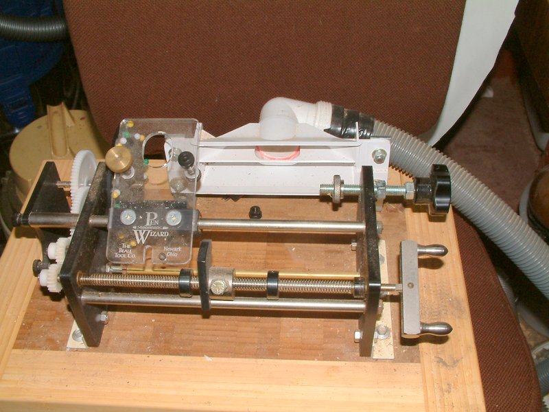

The other picture shows my fitted dust extractor. There were several other mods as well.
The locknut either end of the mandrel eliminated SLIP. Always do away with the point contact to the mandrel my way.
Kind regards Peter.

Peter, where did the dust hood come from please? Really like the idea of it.
