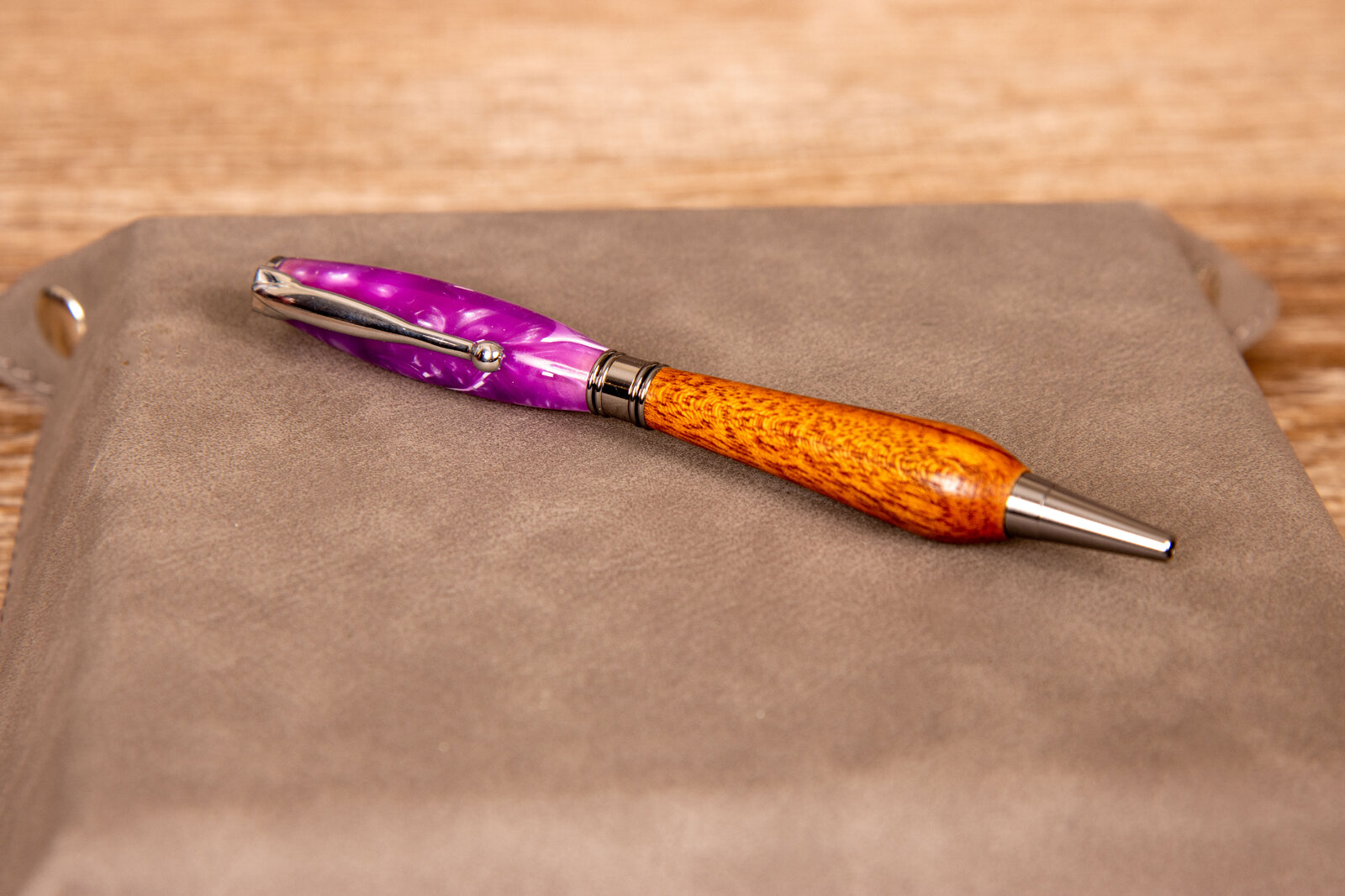

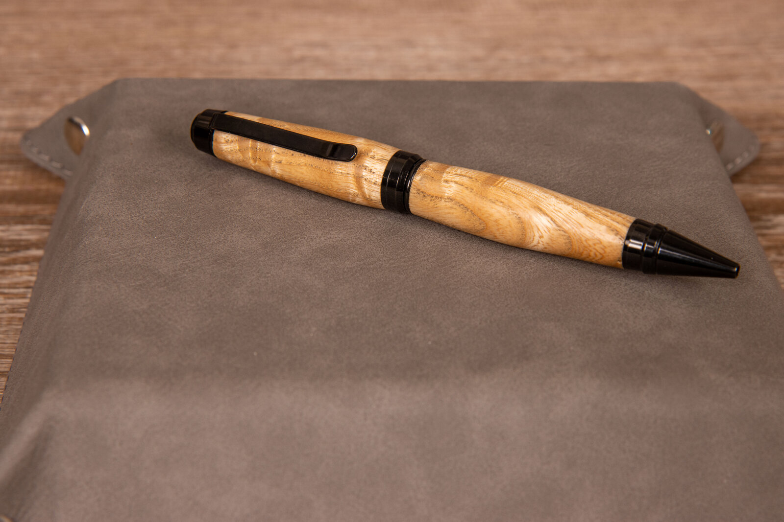

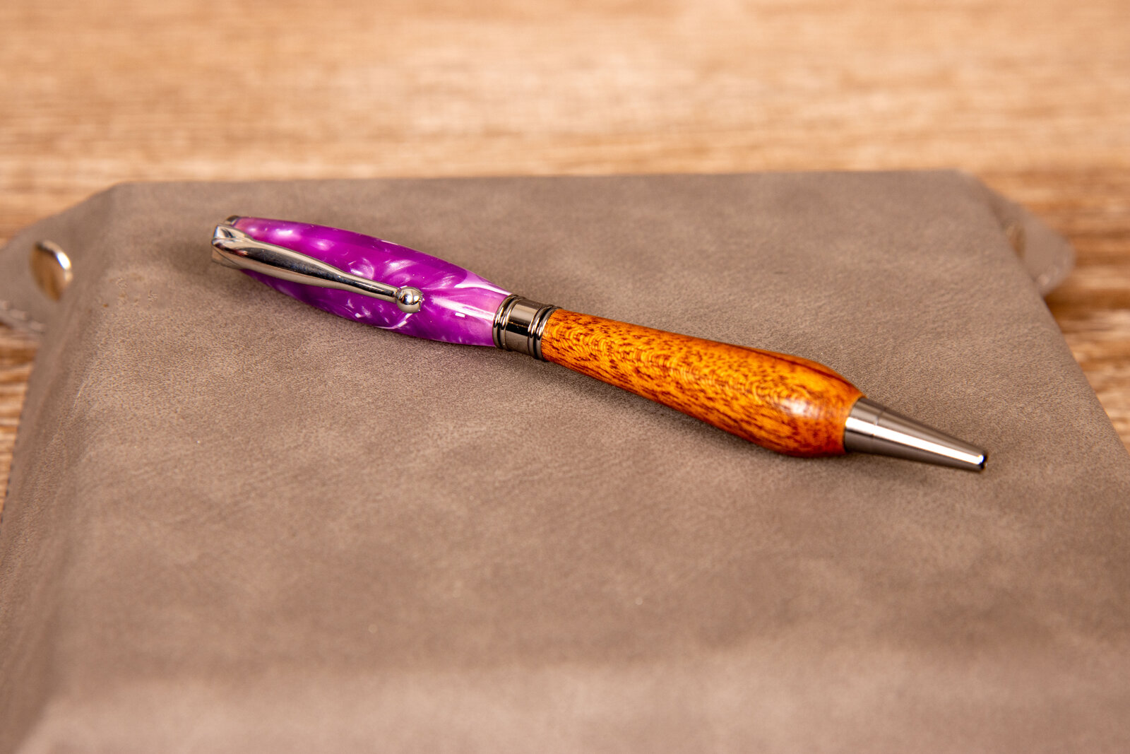

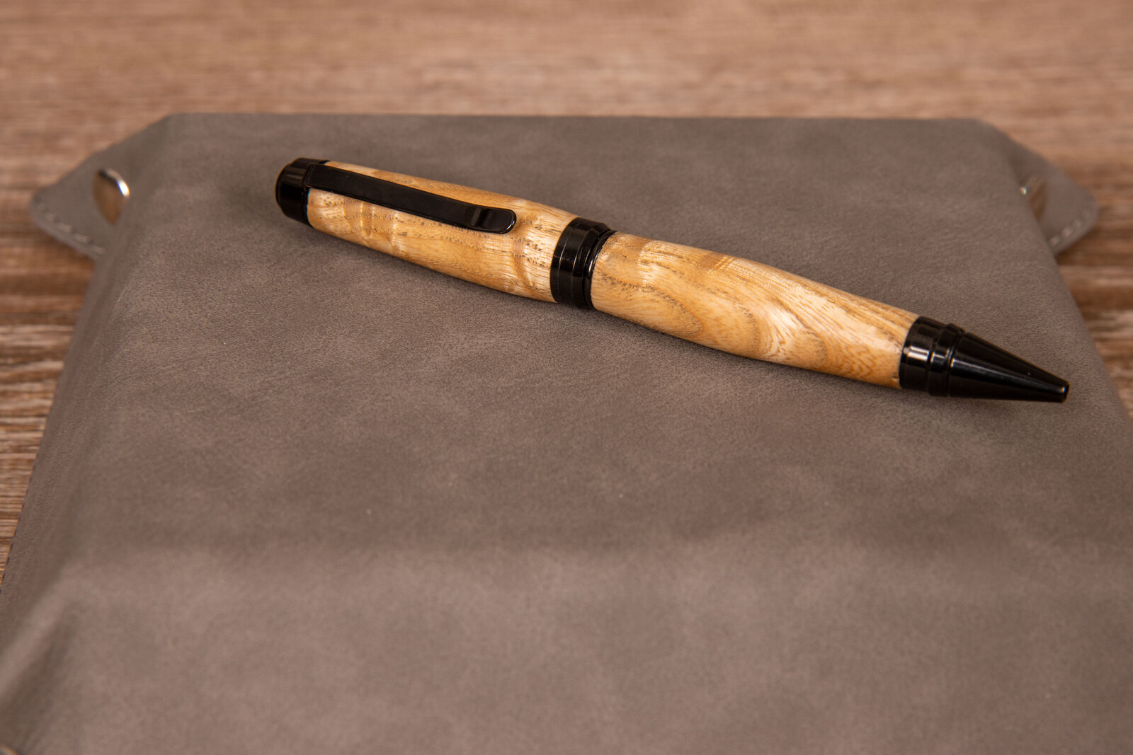

I think I need to raise my pens higher off the surface. I also think I need a simpler background.
I had hoped the tray would be enough, but I don't think it is. Any thoughts?
Also on the composition, is there close up crop better, or should I leave a square aspect ratio?

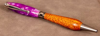

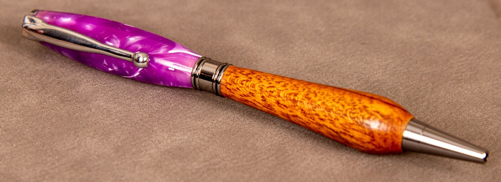

I would crop the first one to eliminate the distracting elements around the surface the pen is lying on. Perhaps leave a little more of the surface showing than in the second photo.
There are several excellent tutorials on pen photography in the IAP library.

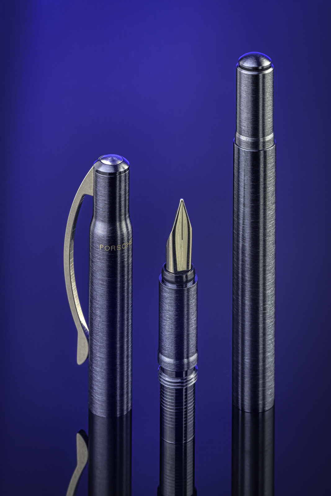

Raising the pen off the surface can help but so can selecting a surface that either compliments the pen or disappears - a common technique for shooting small pieces with a colored and floating background involves painting the back side of a piece of glass with black paint - which does not limit you to a black background - its part of the technique - the object is then placed on the glass (painted side down) and the reflection off of the glass - behind the pen and glass - is lit with a color, black or even an image - this shows up in the camera as if the pen is floating on the reflected color - it takes a little playing with it to understand completely but once you have done it once, its really easy to set up and repeat -
Having a large enough surface so that the entire background is one material or having a distinct "horizon" at the edge of the flat surface can both clean up the image - many products are shot on a "sweep" - be it paper, cloth or other materials that can be curved - the front portion is flat for the product but the surface curves up to a vertical in a gentle curve that makes the foreground and background the same continuous surface but much more uniformly lit than shooting on the front edge of a large flat surface - also enables a lower angle shot without "running out of background" -

Black Glass - blue reflection
