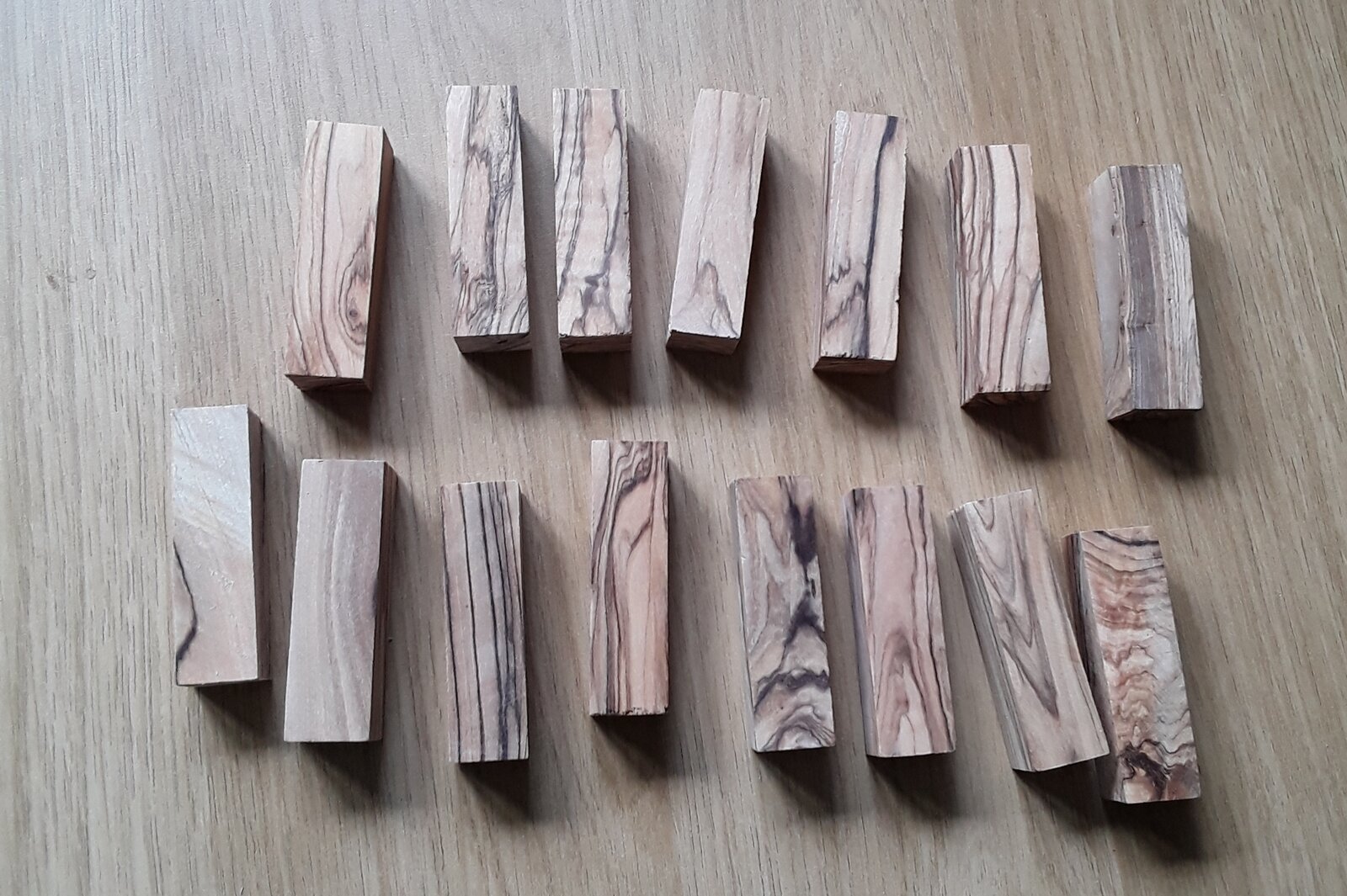

Thanks to you all for your informative input. Unfortunately as I bought these as 2 1/2" blanks I must go with the fact that there will be no grain match. These are the blanks I have to choose from.

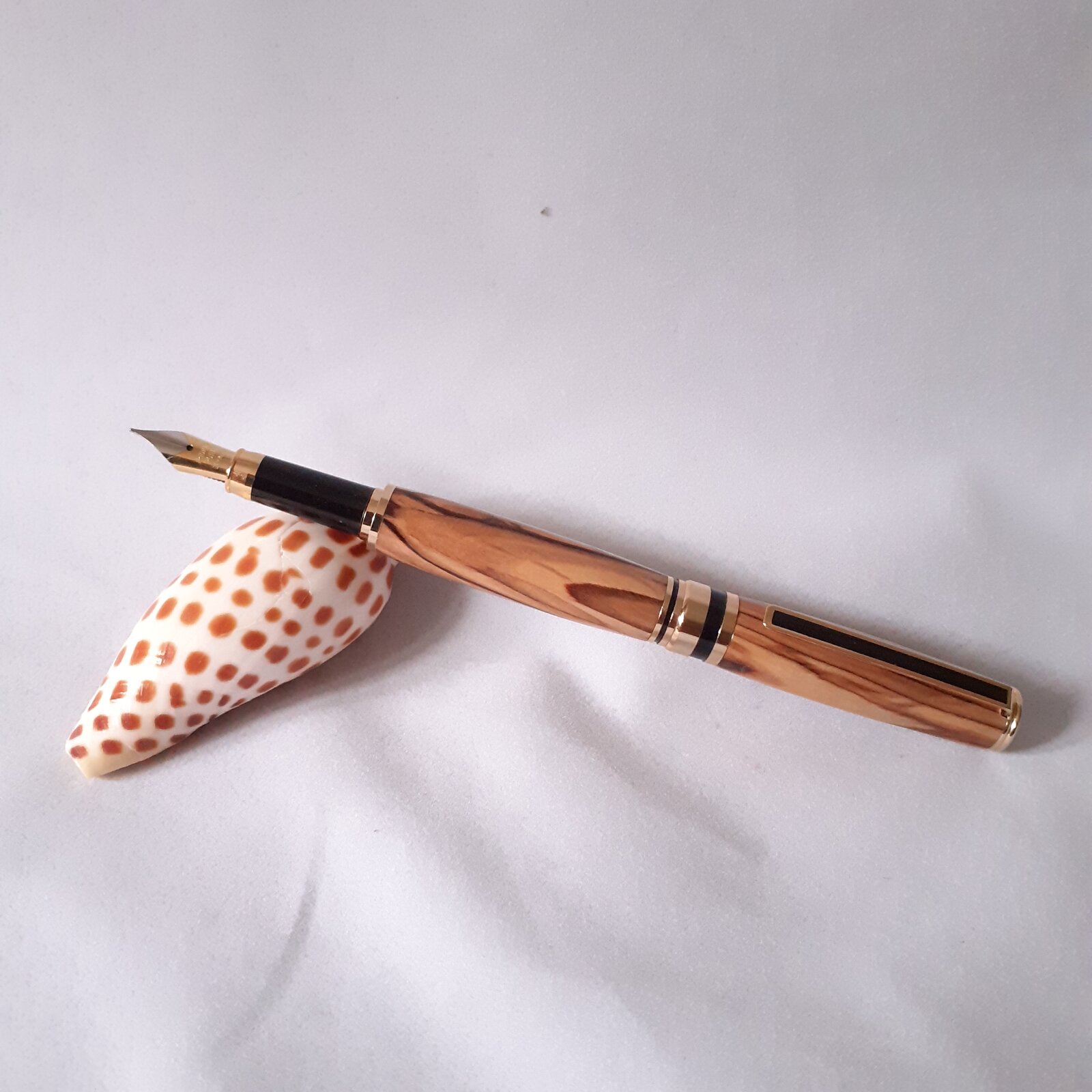

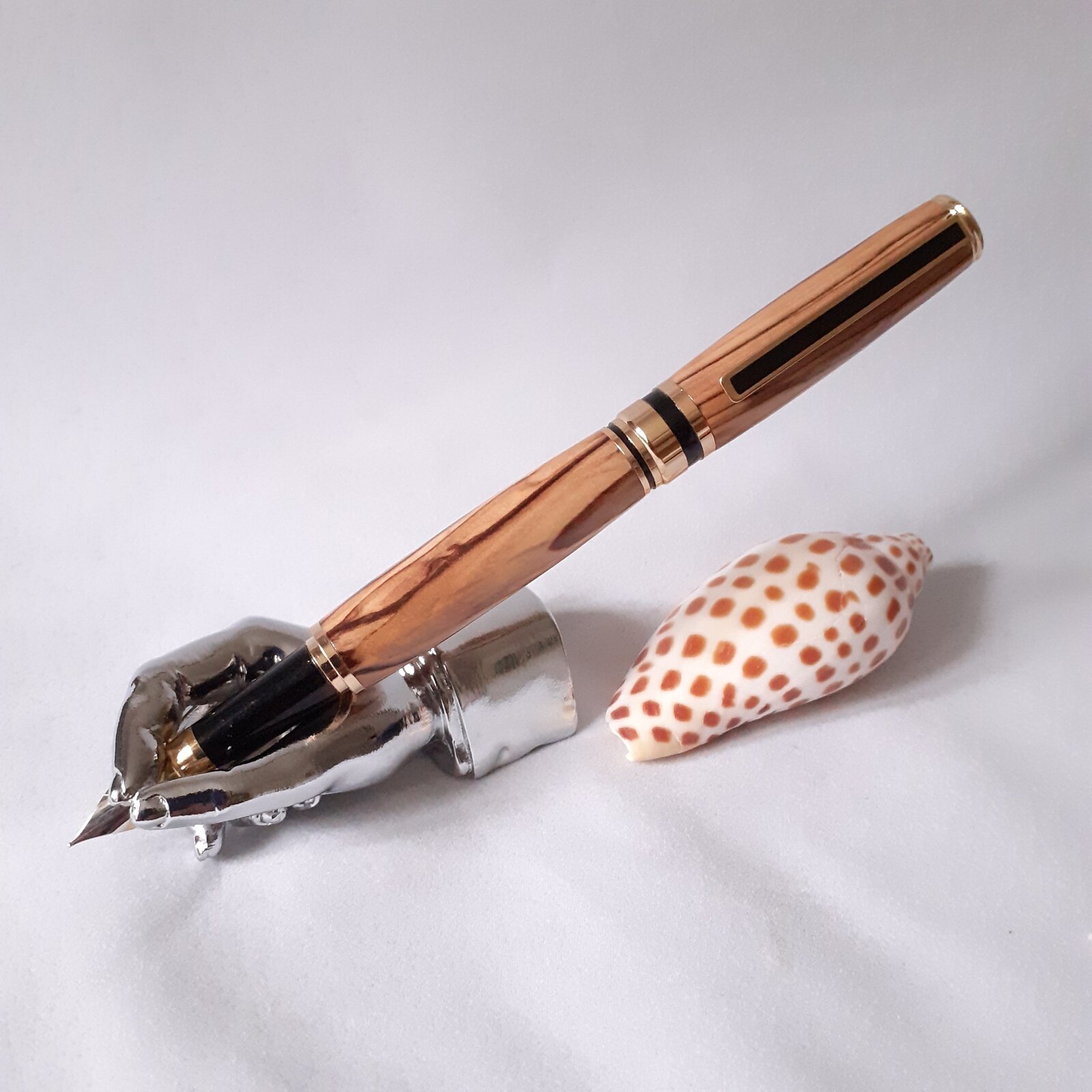

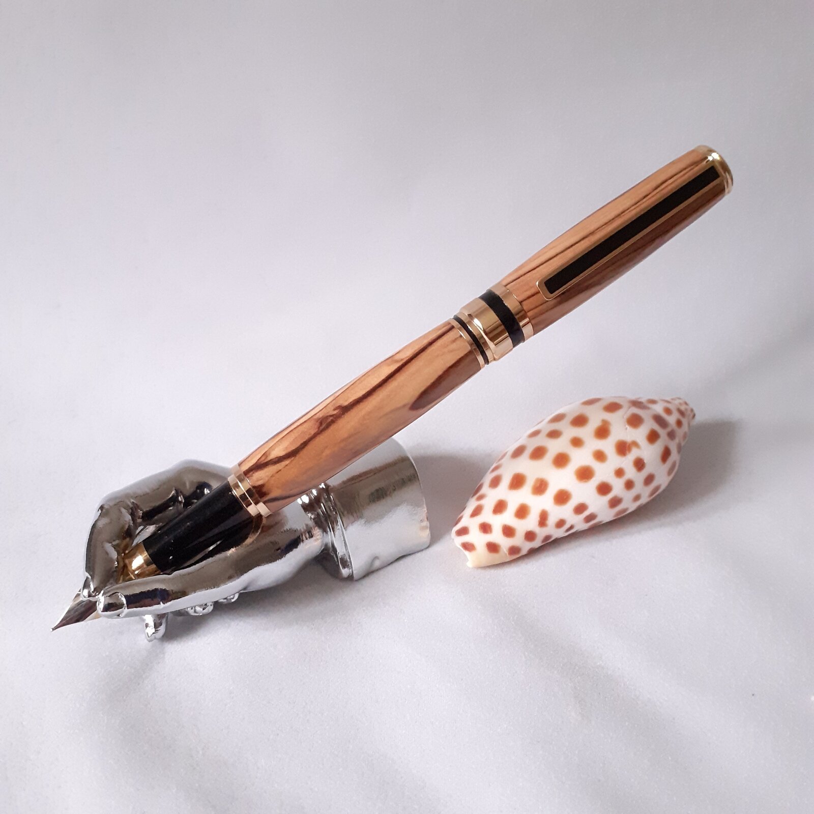

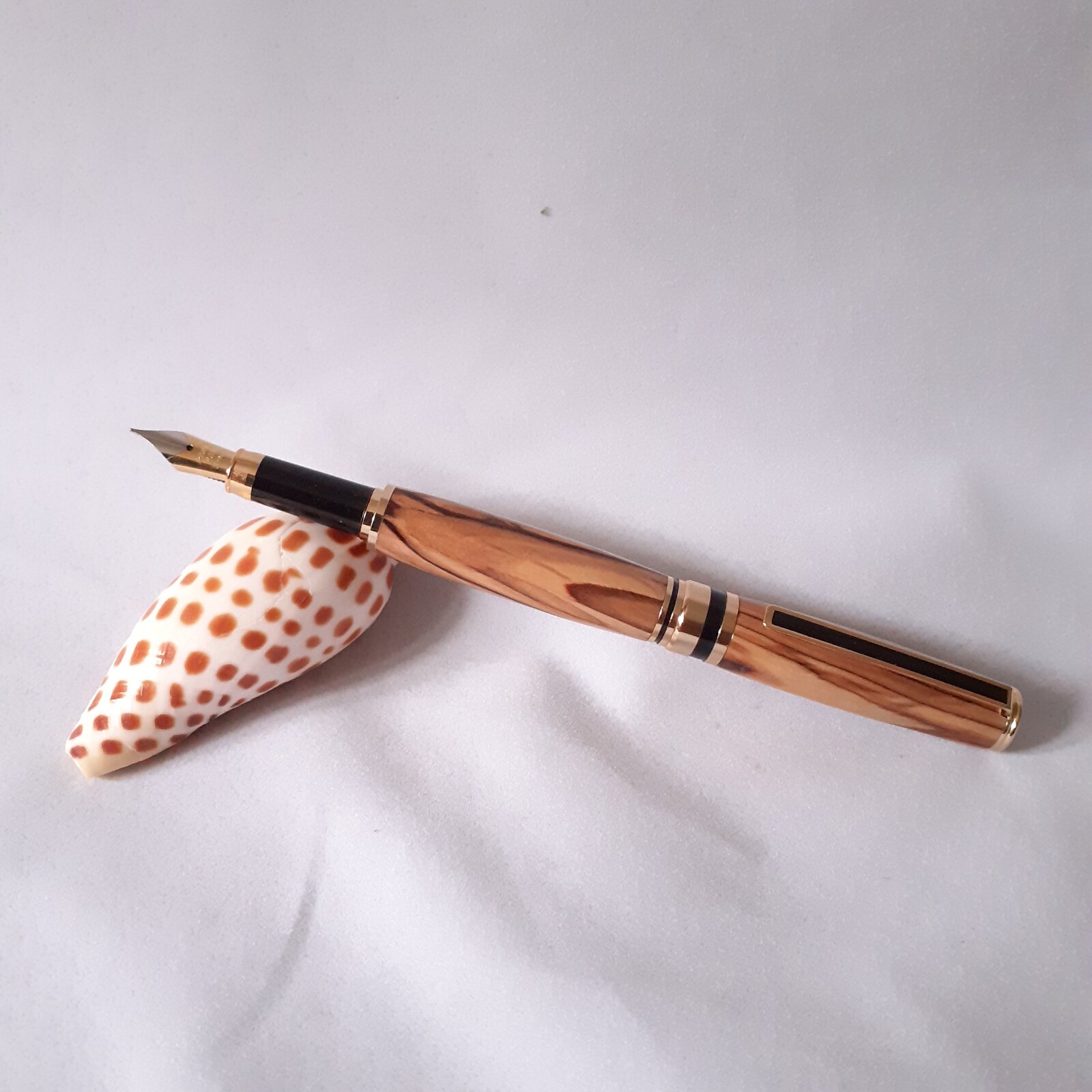

Well this is what ended up doing. No extras just 2 blanks turned to the fittings. I didn't use the TM Omega kit as a friend came round gave me 3 25 mm sq Black Ebony blanks from his father and a fountain pen kit complete about 20 years or over old. I have no idea what the kit is apart from the instructions and the packet it was in shown below.The ink cartridge had all gone hard luckily the same size can still be bought.
Anyway turned out quite pleasing for my first one. I just love the olive wood gotta be my favourite I think

Very nice. I too love olive wood. The kit looks like a so-called "Flat Top American".
Yeah think you could be right the clip is not the one for the pen. Had to use a spare from another kit due to an error on my part.
Thanks
