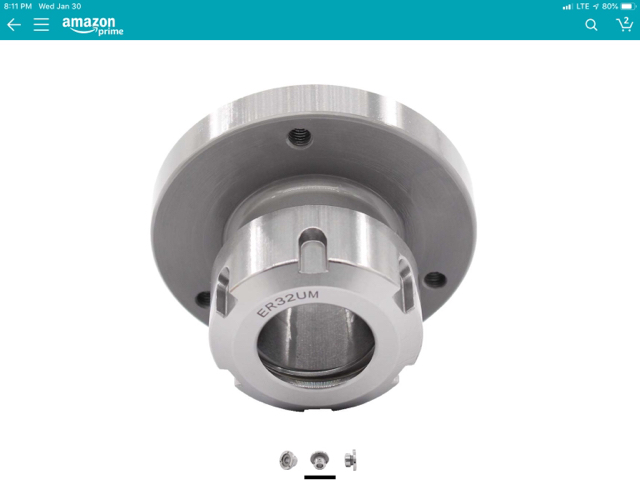

I'm thinking of getting a collet chuck for my mini metal lathe (7 x 10). I am thinking ER32 size works best with my lathe and the sizes I might need to hold. I'm also leaning towards getting a set of 2-20mm collets. Where i don't plan to use them in a mill to hold tooling but to hold blanks for turning pens, I was thinking I could get away with a cheaper set off EBay. Thoughts and or advice?

Dan, I've been looking at the same style of chuck from LMS for quite some time now, but haven't purchased one yet. I have the Grizzly 7x14 and everything I've read and researched so far shows that to be the best choice collet chuck for our lathes. ER32 also seems to be the best size range for pen work. Seems like many people are satisfied with chucks and collets from EBay, Aliexpress, Banggood, etc. Personally, I'll eventually get the LMS version just because I feel like there is some peace of mind concerning returns/replacements, but honestly, a lot of that is due to having never dealt with those other companies.
The chuck on Amazon uses the same photos as the one from Baggood for about $20 more. I'm sure the LMS one is built in China and is likely the same but for $130 vs $50. I might just take the risk on this one.

This is the set I purchased, chuck only. Screws right onto the 1x8tpi head stock
The Beall Tool Company
and got the collets from Aliexpress,
https://www.aliexpress.com/item/Spi...21pcs-from-2-mm-to-20-mm-for/32450726843.html
oops, never mind Ali - when i purchased them there was free shipping, but banggod has free shipping
https://us.banggood.com/Wholesale-W...or-CNC-Milling-Lathe-Tool-wp-Usa-1032144.html
However it takes a lot longer to get them.
Have you purchased from Banggood? Experience? They are a LOT cheaper than what I've been finding.
Danny
Sent from my iPad using Penturners.org mobile app
I originally bought the ER40 because it allowed a 1" piece of stock to fit through the spindle. But After I started playing with the 5C indexer, I wished I had went that route, but it also would have meant that I lost some of the distance between the head and tailstock. The extra 1/8 capacity was no worth the lost of length. The ER40 goes from 1/8 through 1" which was enough for my making tooling for game calls.
Wow, that's a significant price difference. If you do order one, please let us know how it works out. I may have to change my way of thinking.....

Yes I have purchased several things from Banggood - so far everything is good. I have several collets and other tooling from them. It is decent quality, nothing spectacular but quite usable. Depends on the vendor, but a lot of times if you are not satisfied you can usually get a full refund and keep the product. Only issue I have is the shipping time, usually 3 to 4 weeks - slow boat from China.
Are you wanting a collet chuck for your mini-lathe in order to improve the precision of your drilling and turning ?
Do you think it is worth it to get the improvement you expect ?
Once you have the collet chuck installed are you likely to see the need to switch back to a 3-jaw or 4-jaw chuck ? . That takes time.
I know you can leave the collet chuck permanently installed and do your turning between centers with it, using the appropriate collet and driving center.
Just thought I would ask these basic questions in hopes you can enlighten me as to possibilities. . I use a mini-lathe with 4-inch 4-jaw chuck for all my pen turning and I feel that I can get quite good precision that way ... down to 1 thou or so.
Using a collet chuck means a little more time/effort if/when you want to actually insert different size round blanks ... compared to using the usual 3-jaw or 4-jaw and a chuck key.
Most likely Amazon is getting them from Banggod or at least from the same vendor. Check where it ships from. If it's not in a amazon warehouse or fulfillment center it will most likely come from china and take 3 weeks.
Amazon doesn't seem to be the great deal it use to be. I have found many items on there that I can get cheaper straight from the manufacture.
Danny,
The style of chuck that you are looking at is probably the only thing that will work on a 10" lathe. Anything else is going to take up too much space. Have no idea if there is any quality or precision difference between sources. FWIW, mine came from LMS and with a high quality collet I get less than .001 runout.
As far as collets are concerned, there are videos up on YouTube that indicate that some of the cheap chinese sets can pretty bad in terms of runout. If you're talking about work holding only, it probably doesn't make too much difference. Again, if work holding is your only objective (depending on pricing) you might want to consider just buying individual collets rather than a set with the smallest somewhere around 3/8". I don't think I've ever used any of my collets that small for work holding.
Oops! just looked at Banggood pricing. Just buy the set. If they are really bad you can throw them at pigeons or something.
Bill
Danny,
Bill
A MT3 holder would work and be more accurate but I like the ability to recess the material into the head stock.
Price is good enough to try I think.

Thanks for the information. Banggood has the ER32 chuck on a back plate that mounts to the 7" mini metal lathes for $50 and a set of 2-20mm collets for another $45.

I ordered the flange collet chuck and ER32 collets from 2-20mm in 1mm increments for under $100. I was happy to also find carbide cutters and holders for wood turning at a fraction of the retail cost at banggood.com thanks for sharing the link. 10 carbide cutters for $20 and a holder for $23; just need to make a handle. I'll find out if this deal was too good to be true in a few weeks. Just about everything is suppose to be shipping from a US warehouse in 5-7 days.

I know this is an old thread, but I came across it and see I needed to give some thanks and feed back.
Thanks everyone for all the advice and tips, especially the Banggood source.
The flanged ER32 holder works great and I have gotten efficient at swapping it out for my chuck, no big deal. However, I don't really have to swap them often. I find I use the collets for just about everything I do on the lathe. I've since purchased several more ER32 chucks for turning. I have a MT2 version I use in my metal lathe tail stock and on the head stock on my wood lathe. I also have one with a straight shaft I modified as a tap holder that works like the LMS die holder. I use this for specialty dies that don't have a dimple in the back for the LMS tap guide.
Thanks again everyone for all your suggestions.
