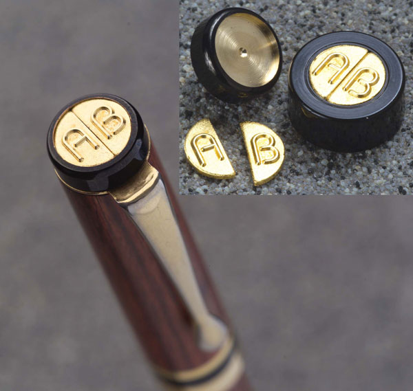

There used to be metal initials commercially available that you could mount in pairs as an end cap on a Jr. Gent size pen. Sorry, can't remember further details but maybe someone else's memory will help out in due course.
