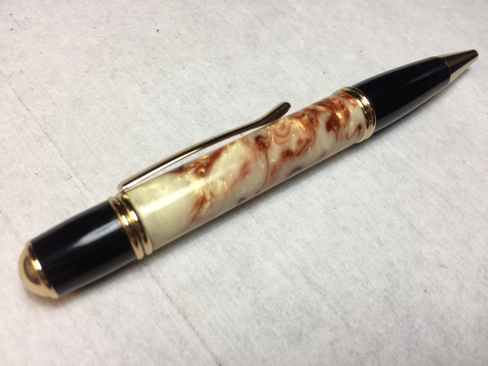

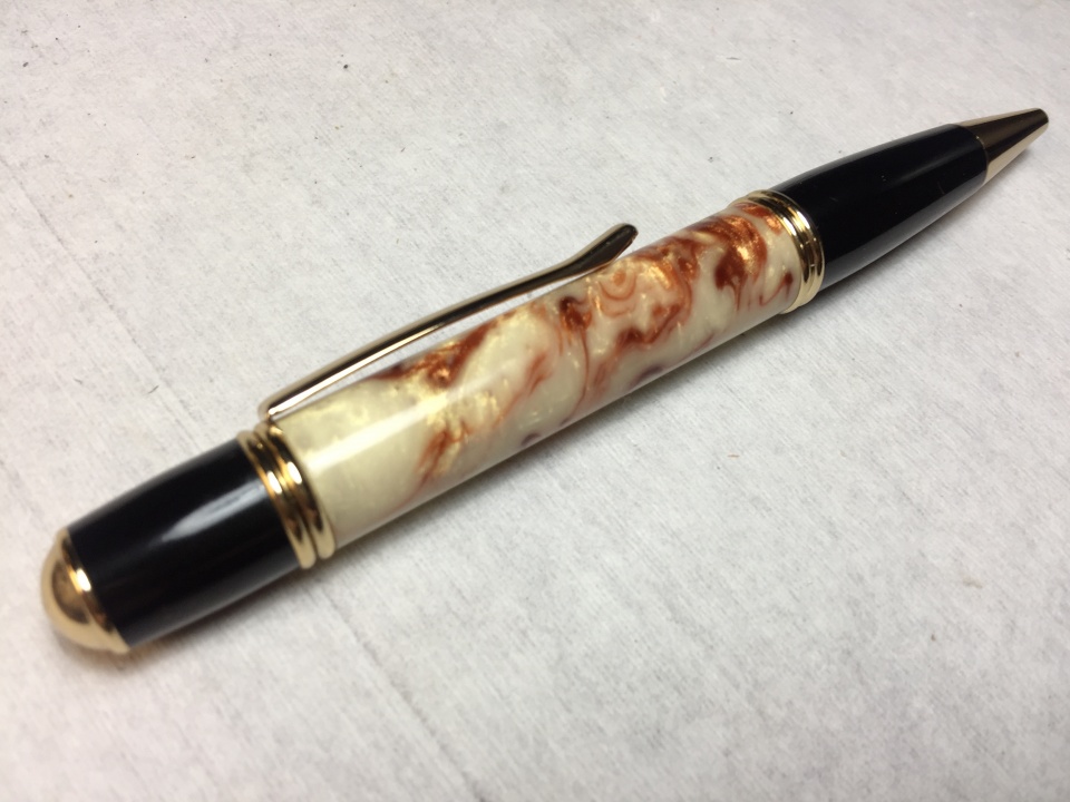

Hi folks,
I completed my 3rd pen using Crushed Gold blank with Gatsby Grande 24kt gold from the bundle of 5 I bought from PSI. While the blank turned out rather nice, it doesn't seem to match well with the 24kt gold hardware as expected (my wife and buddy said so). Maybe because of the black portion of the tip and top cap. lol
Love the look of this blank:
But doesn't seem to go well with the kit:
Can anyone give me a tip or two for matching hardware with blanks? A general idea or two to get me started.
I'll be buying more kits and blanks, probably from PSI again (unless I found another source with the same purchase experience).
Thank you in advance.

Not true. Just about anything goes good with black and gold or silver. The black maybe be too dominant to your eye and that is what is throwing things off. Go with any kit that does not use plastic such as any of the 2 piece kits. or a Zen kit
It looks OK, however I would have used Gun metal to contrast the gold in the blank. It looks odd because "everything matches". I recently finished a pen for a friend of my wife. It was an Orange swirl blank and I used an Antique Copper slimline. It looked OK and she loved it but I thought it looked a bit odd because there was not contrast. A black slimline kit would have looked better I think.
Thanks guys. 2 friends replied when I posted it on my Facebook page (being a newbie, I would like to find out what's popular) that they like it. I gave it away this morning to my staff when she said she likes the look of the pen.
I don't think it looks bad, either. I'm not a huge fan of gold hardware, but I do use it with select blanks.
Here's one of my pens with a similar blank, the gold Executive, just for comparison:
Matching blanks with kits or plating is often a matter of personal taste. It is the same for different styles of kits. What one person likes another will not.
When I started out I often made Sierra style pens. I would turn 3 to 5 barrels at a time. I would then layout all the Sierra kits I had with different platings and play mix and match with the turned blanks and kits. My wife usually joined me in the fun. It helped me learn what I liked.
Just remember, this only tells you what you like. I have turned a few pens that I didn't think were very good but someone else thought they were fantastic (and bought them) over ones I thought were much better.
Thanks for the pic, very nice looking pen you made! From your pic, I see what John T mean now when he said that "the black may be too dirminant...". The blank goes well with little or no black per the pen you turned.
