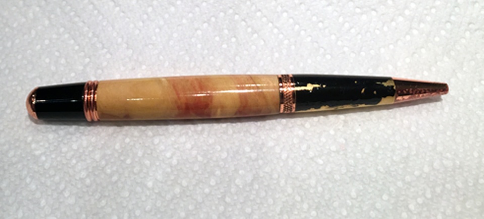

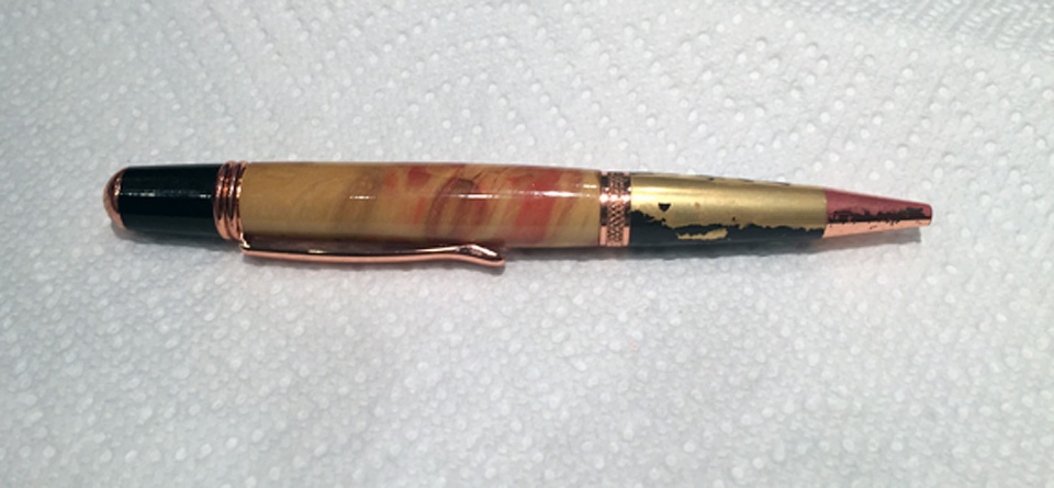

I wanted to see if some of my experts could give a bit of advice.
I sold this pen to my neighbor (so I must be nice) months ago. He brought it back to me today asking if I could fix it.
As you can see from the pics, the finish is coming off the tip. He tells me he clips the pen inside his shirt where it buttons, and carries it around outdoors (he's a car salesman). The tip of the pen is always rubbing against his skin inside the shirt. I told him that his sweat (we're in Texas) is damaging the finish. Constant moisture, rubbing, not to mention the salt, is doing a real number on the pen!
I know the tip is shot, so I'm going to replace it. Is there any way to maybe clear coat the component in order to protect the pen from the "elements"? If so, can I get some advice on how to do it. If not, are there any other suggestions?
I'm going to suggest he not carry it against his skin, of course. But he's my neighbor, so I want to try to satisfy him.
Thanks for the advice,
Steve

The platings look like copper and gold. Neither stand up well to normal wear. My suggestion would be to replace all the compeonents with better platings. You should be able to reuse the blank.
Others may suggest another solution.
I have had that experience with the gun metal finish on an Atrax FP. However, I am the one using the pen and my hands are usually dry - don't get it.
If you can't convince him to go with chrome for replacement, you could take the replacement front end and put it on a Big Grabber Closed End Mandrel (complete with tip of the pen) and add a few layers of CA for protection .... then polish it up really good with Plast-X to make it clear and pretty much invisible...
It would seem that the CA finish on the actual pen barrel held up just fine, so that should work for your needs, as long as he isn't dropping it very often!

I have another copper Wall Street II kit, so I tried what Skie M suggested. I rigged my pen mandrel and got the front end on the lathe. I applied a few coats of CA and tried to polish it up a bit. We'll try that for now.
My advice to the neighbor will be to carry the pen somewhere else on his person! In the meantime, maybe the CA barrier will help for a while .
I'll also let him know that I can swap out the copper kit for chrome or stainless if he wants to go that way
Thanks again
