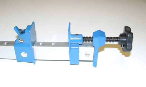

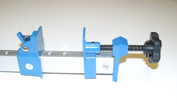

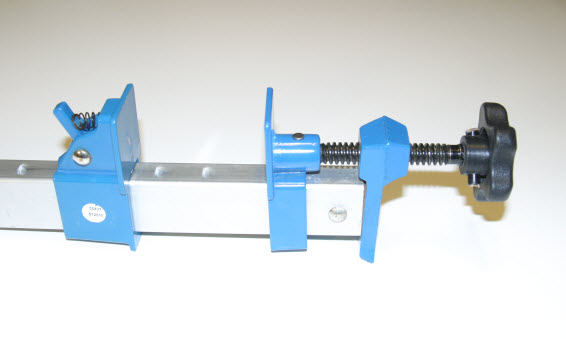

I tried the arbor press, and others, and have settled on using a bar clamp fro HF. Attached a knob. I find it gives me finer control.

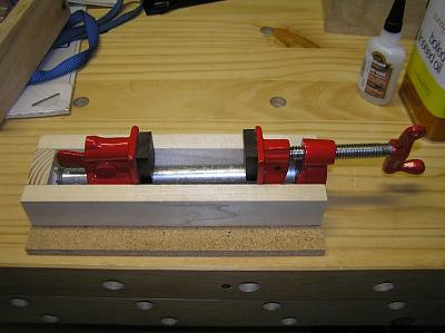

I used a similar approach with a pipe clamp, likely also from HF, mounted in a little holder as shown. Epoxied on wood blocks so as not to mar any parts.
