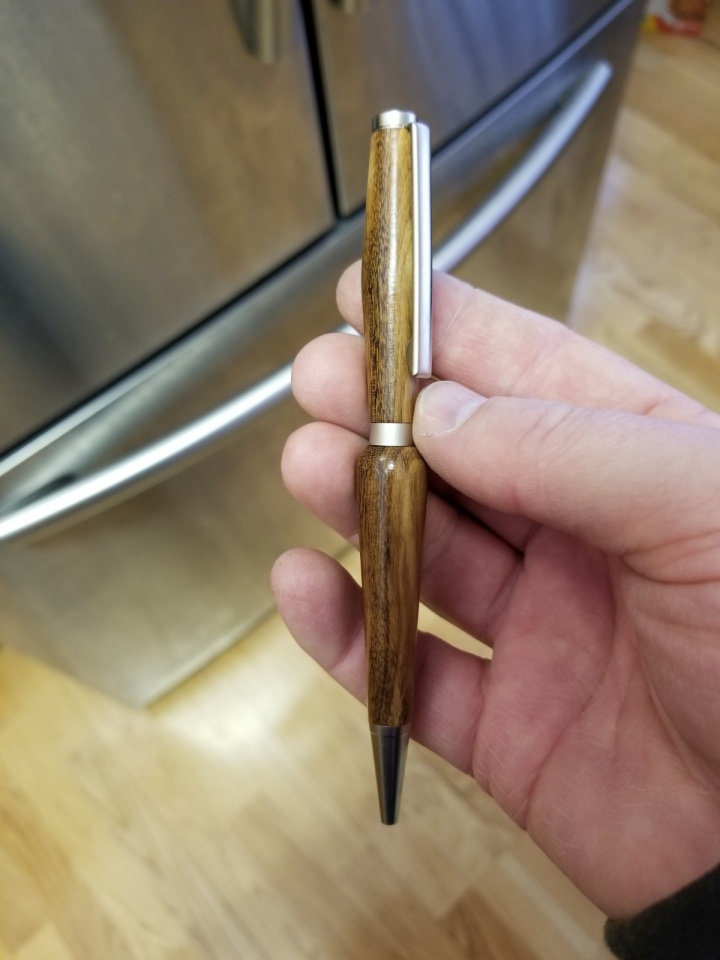

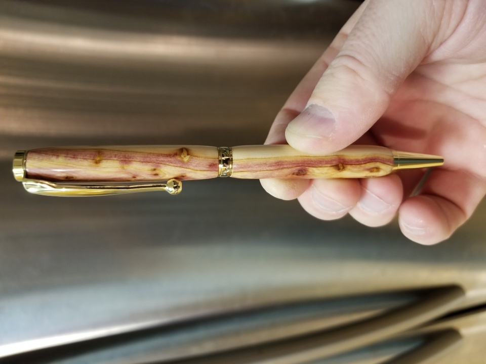

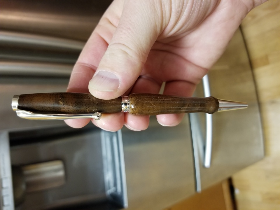

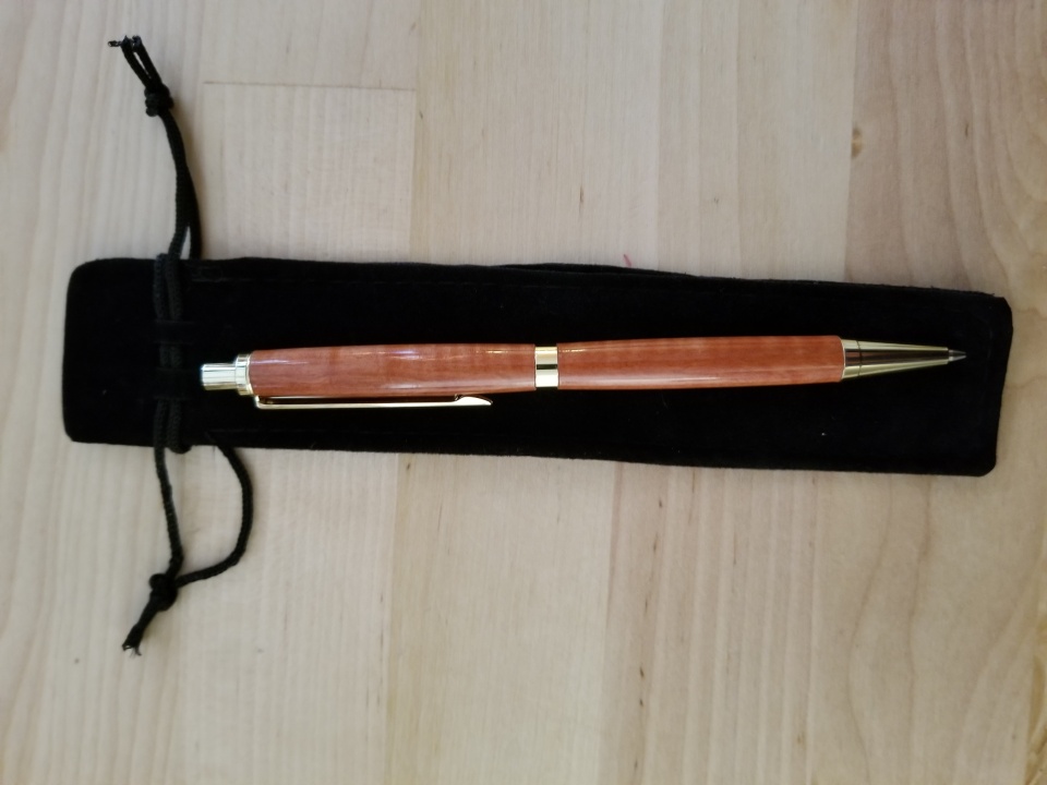

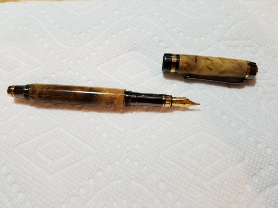

So far, I've used kits; moreover, I've made 11 slimline pens, 1 slimline pencil and 1 "classic elite 2" fountain pen. I've added a few pics as you requested.
Thanks again for any and all advise.
(Sorry some of the pics are rotated)

Well Jay thanks for posting some of your work and I have to say well done. But to me I am confused because all pens you shown are relatively light weight pens. There are many kits that do get heavier because the are a larger kit but mostly are capped pens and as I say just leave the cap off when writing with and the weight is far less. The pens you show use a transmission but that basically is centered in the pen when assembled. Maybe tipped a little toward the top. I suggest you do a balancing act thing and see if you are really seeing a top heavy situation or just a grip thing. Many times people can not grip thin pens well because they do not have the finger pressure. Lay the pen on your finger and try to balance it or lay it on an object where you can balance it and see if it tips toward the cap or the nib and by how much. I bet you will be surprised it will not be much if at all.
Now if it is a grip thing or there is a slight inbalance you can always change the profile of your turning in that make the bottom portion more bulbous in shape and that will add some weight to the nib or vice versa if the cap needs more weight. You see many people do this for people who have a hard time gripping a pen and this makes it easier. There are many examples throughout here and maybe others can post photos because I do not do this type turning. Good luck.

Thanks for the comments thus far, all. It is the fountain pen that is the primary "offender".
Considering these comments, I suspect you've all touched on aspects I haven't considered (e.g., the way we hold pens, familiarity with the Bics of the world, etc.). I think you guys are right with respect to the slimlines; regarding these, I'll just keep the thought in my back-pocket if ever I find myself concerned again.
This does leave the fountain pens unresolved. This particular FP kit uses a 10mm brass tube for both barrels. I noticed other kits use a larger diameter tube for the cap which would change the weight and shift the balance some (perhaps, insignificantly). Additionally, I don't have much experience with using fountain pens so I'm beginning to suspect experience with more varieties could help level-set my expectations.

You could take a kit fountain pen, and reduce the length of the body so that it is comfortable when posted. Keep in mind, that then you would only be able to use a single Intl ink cartridge, and no converter.
If you go the non postable route with kit pens, you can reduce the rear weight by removing the rear finial. Either do a closed end pen, or do the barrel as normal but instead of the included hardware, creat a small wood plug to glue in and close the end. This will actually drop a lot of weight from the rear of the pen.
