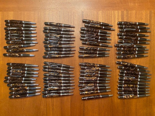

This picture is a batch of 80 custom pens we made a couple weeks ago. Less that a week total time and not working full time,

Chasper - Some of the most comprehensive information that I've seen on this site for those who might do ANY selling. Sound advice! Thanks for taking the time to do this.
