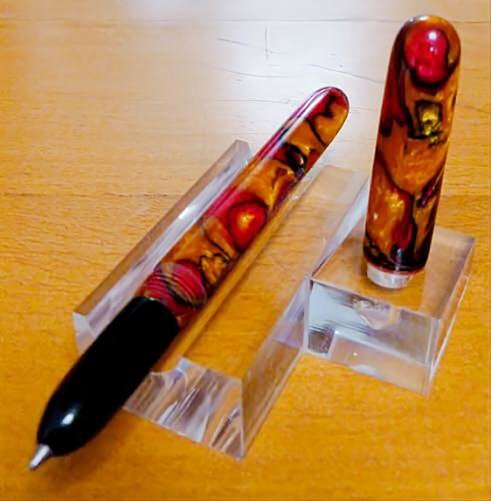

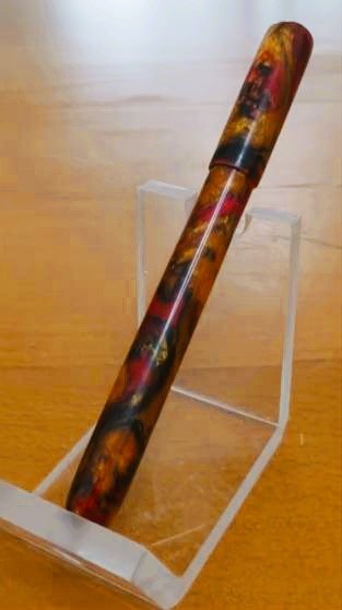

I have now made a pen, and although I always enjoy my pen turning it is so much easier, quicker and more pleasurable using the Hinze Tenon Cutter. The materials are black ebonite and Pearlux Alumilite from William Wood-Write. This particular Pearlux is one of my favorites, and is popular with my customers. I really like black ebonite as a contrast section color. The sizes are M11 x 1 and M8 x 0.75.
I get a few requests for "smaller" custom pens, mostly from ladies, and this is my attempt to meet that demand. I am calling it "The Handbag Pen". It has a 12.1 mm diameter cap, an 11.4 mm diameter barrel, and overall length of 4.5". By making a 25 mm section, and using ebonite, I was able to make the complete pen from one 5.25" blank.
To cut the tenon on the section I used the approach mentioned above. Ebonite cuts quite nicely, and I got a good 8 mm tenon right away. For the cap thread on the barrel I could use the 6 mm rod supplied with the kit, and it is clear that doing this is superior. Makes me think about reduced rods......hmmmm.

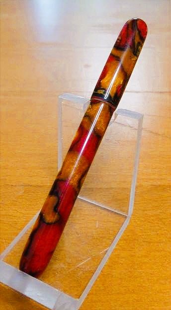

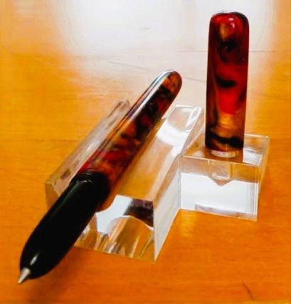

Having made a pen for a Parker refill, I challenged myself to make one for a Schmidt rollerball refill using only one 5.25" blank. The Schmidt is longer and about 0.5 MM thicker. The extra length can be accommodated but the extra thickness with an M8 x 0.75 thread makes accurate drilling essential. Even then you will have very thin walls, making it rather fragile. Having got through a "few" Ebonite sections, I finally managed it. The cap is 12 MM in diameter and the barrel 10.5 MM in diameter. I didn't set out to go thinner than the Parker version, but clearly it can be done. In order to accommodate the extra length the section needs to be a little longer, thus reducing the length of the barrel. In the Parker case you have a little leeway in the total length of cap plus barrel, but none with the Schmidt. Using an M8 x 0.5 MM tap and die, might make things a little easier. However, I don't plan to purchase plus appropriate mandrels. Moving up to M9 x 0.75 MM or 3/8"-32 is the answer.
