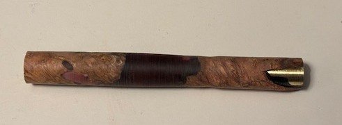

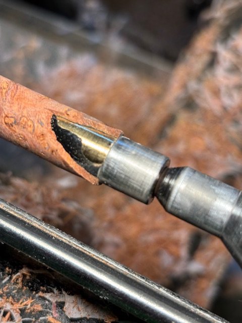

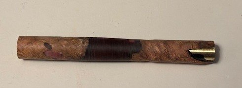

The tube is painted with black acrylic paint as is the inside of the blank. Epoxy is applied over the black acrylic and inserted into the blank. This is the second time this has happened. It looks like the acrylic came loose from the brass. This is for a narrow pen and as you might expect this is when it happens most. Should I use a different paint?

so I have a different question on this.... perhaps two. This photo looks like the glue fractured and not your epoxy
1 - does the piece that broke off show glue on the broken chunk still?
2 - what kind of wood is involved in this cast? Usually epoxy fixes most ills. Perhaps its too oily or something?
The only other question or thought I've got is to make sure you look down the hole in the blank when getting the glue applied across the hole. Part of me wonders if this blank was missing some glue and fractured because nothing was holding it on to the tube?

First line should have been "it looks like the paint fractured and not your epoxy" Sorry about that. Epoxy possibly bonded to the pain and not to the actual tube therefore maybe it "broke the paint off" because that was the weaker bond location? Not sure but it has me wondering
My wife found the broken off piece and it has the black acrylic on it so as you said, the acrylic let loose from the brass. Makes sense because the glue was on the acrylic, not the brass. I've super glued it back on and it fit nicely. Doubt anyone will be the wiser as it'll be under the pocket clip. If I complete it without buggering anything else I'll post a photo. Again, thanks for your responses.

From the positionof the break it looks as though the mater extends slightly beyond the tube. If so, the pressure on the material from the bushings is your problem regardless of painting or gluing or scuffing the tube. Make sure you trim the material down to the tube.
