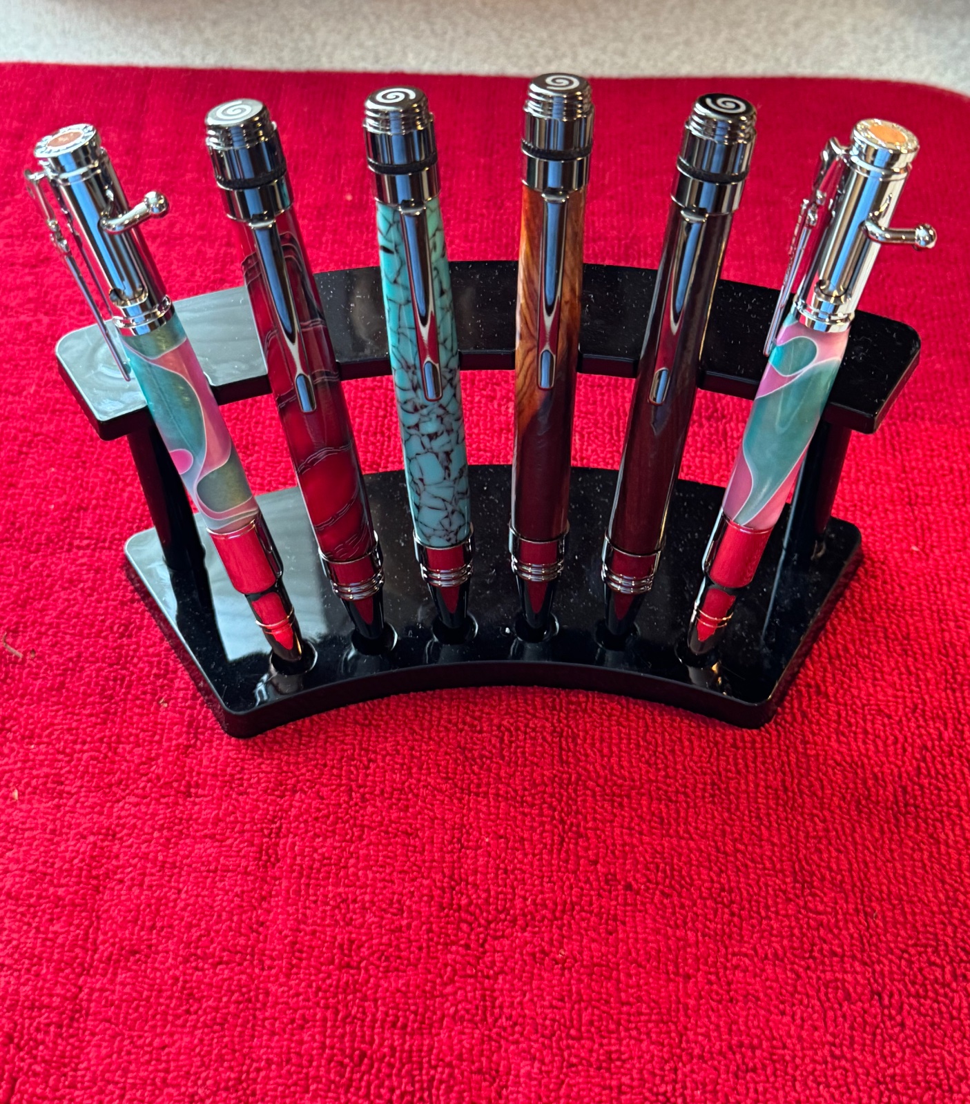

I bought some acrylister pen blanks to try out, I tried to make 4 but after drilling the hole only 1 made it. So before I screw up the only one I managed to save can someone tell me the speeds to turn this? And any tips welcomed. I've turned acrylics so I'm hoping it's like those. Thanks! I'll attach some fidget spinner and bolt actions pens I made for a show upcoming.

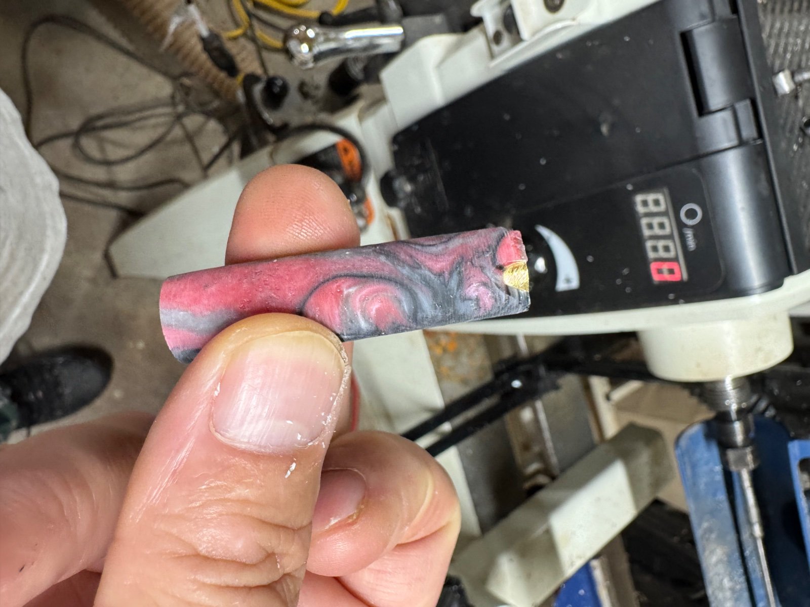

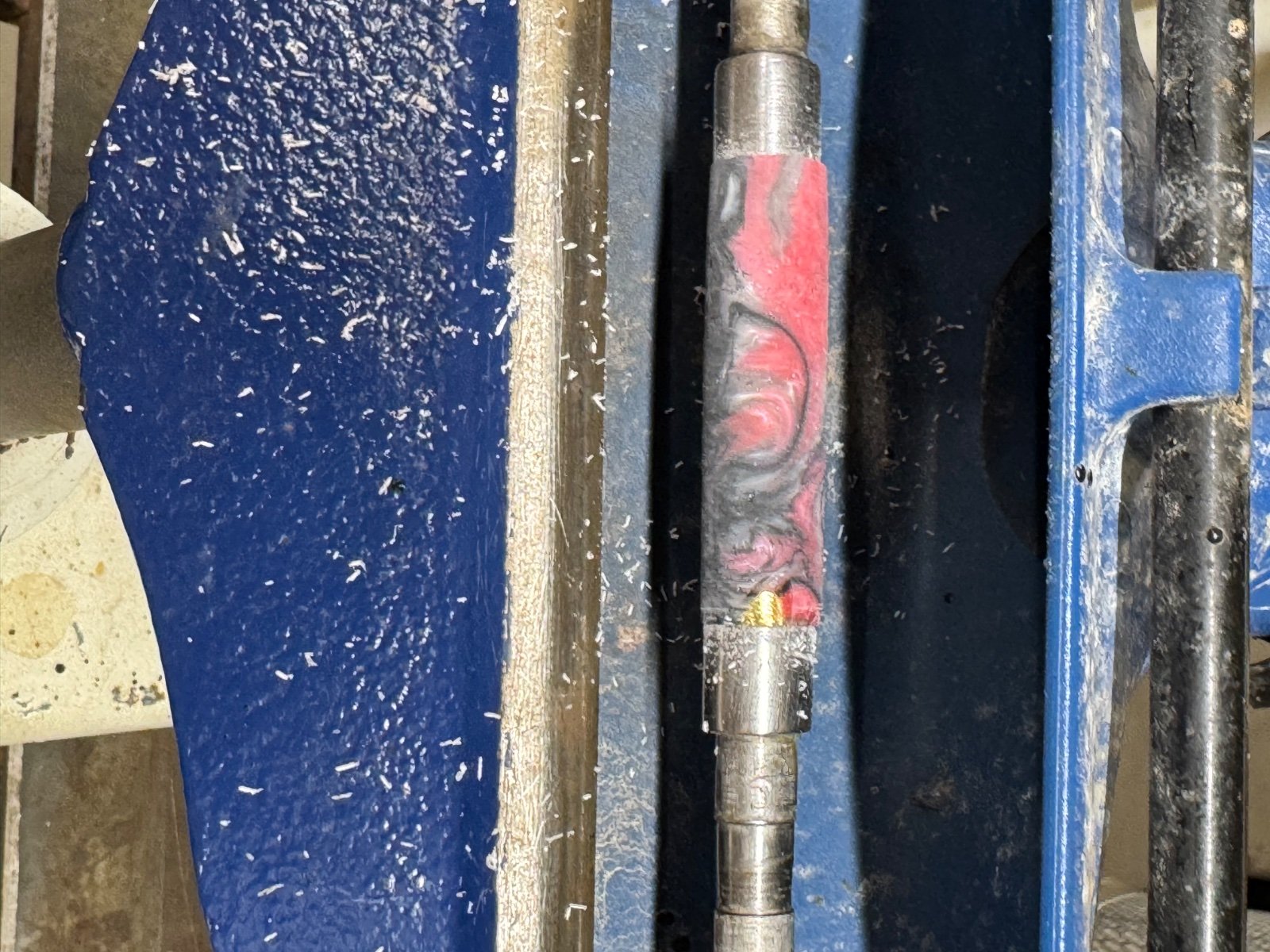

I have that 1 more and I'll swap to sanding syndrome. Was looking so good too. I have some more blanks I'll try in a few days…hopefully one more post with a snazzy pen to show.

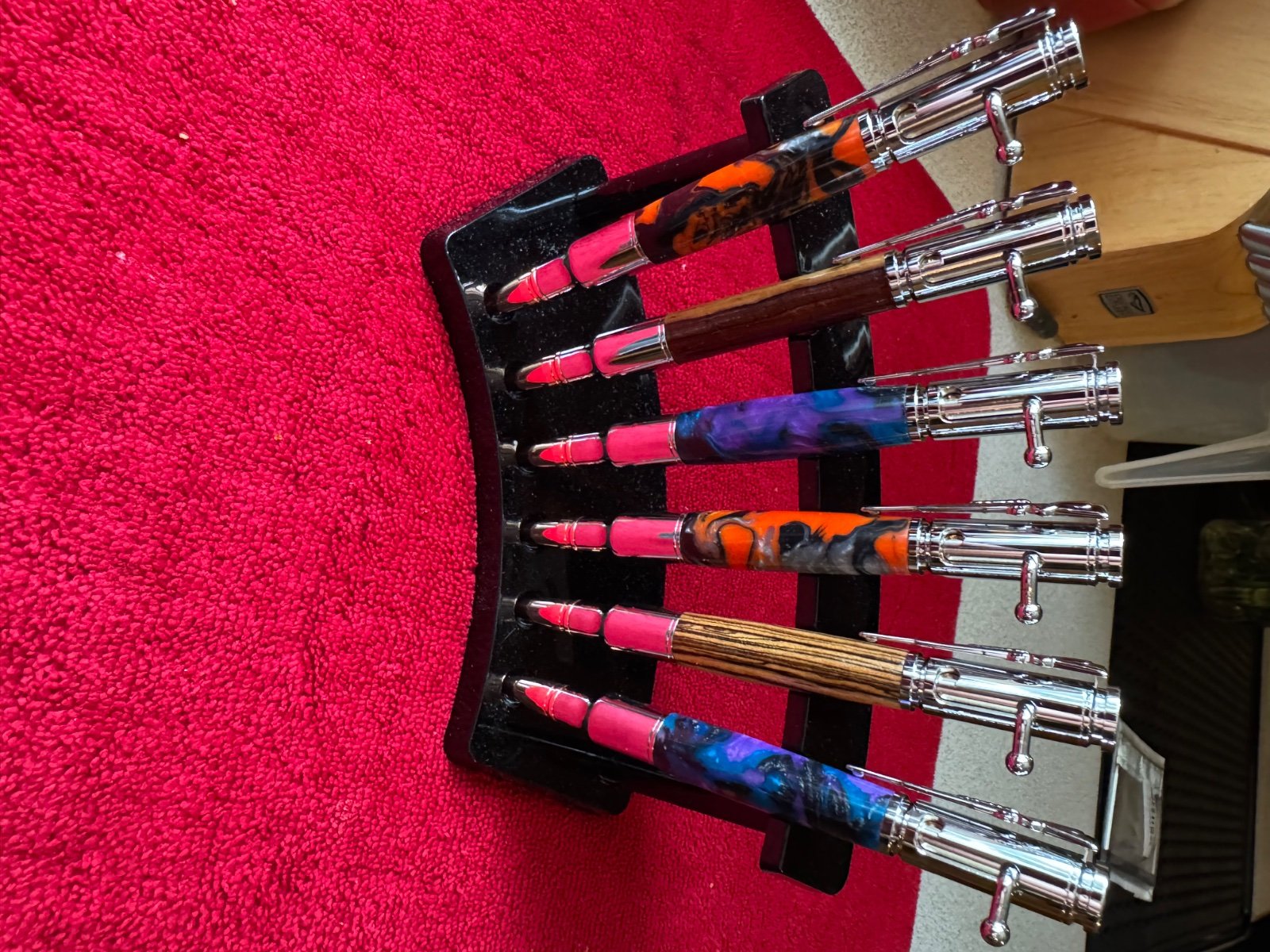

Well I got some acrylister pens done! 😀
First thing I did was buy a new drill bit with the point on end and I did purchase a negative rake from PSI. Then I mounted blanks on my lathe and measured exact spot I want to drill to so I didn't blow out end, I just used tape on drill bit and drilled at 600 rpm and went very slow and cleaned out hole often. Then I turned blanks at 2550 and had no problems at all, I did a break here and there getting a drink or whatever to keep blank cool. I used everyone's advice and it went smooth thanks guys!
