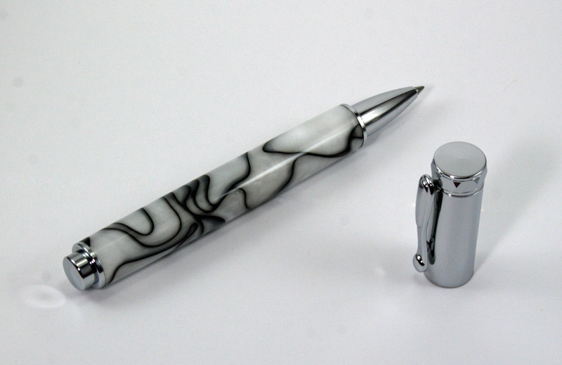

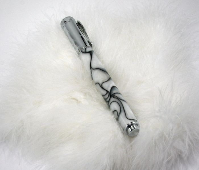

My 4th completed pen is a Zen Pen, from CSUSA. I now have a new carry pen!!
