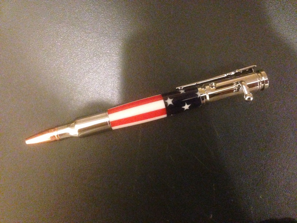

My 1st Stars & Stripes Pen
Things were going well with cutting the blanks, drilling, & glue up until the lathe work. I discovered this material really needs higher speed for roughing out the blanks. I ended up with moon craters peppered all throughout both stars and stripe sections. Fortunately they all went away after enough material was turned away but it was really close. This blank set seems completely different material than all the other acrylics I've turned (which isn't but a handful).
