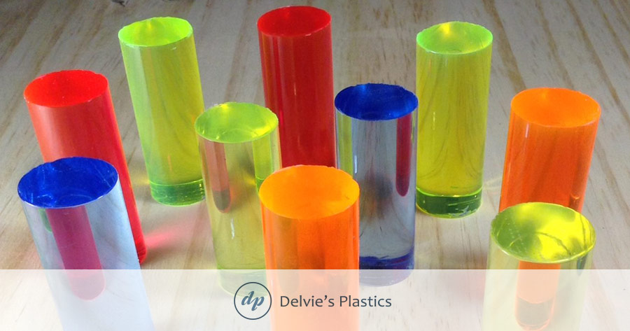

Try delvies plastics. Rods are cheap, but you have to order a certain dollar amount in order to get normal speed shipping (last I checked)
They are my first choice for transparent acrylics.

I have bought cast acrylic rods from Delvies and from US Plastics, both good.
I also made the mistake of trying to save money by using extruded acrylic rods. They are unstable - at best they distort as you machine them, releasing tensions formed when they were made.
